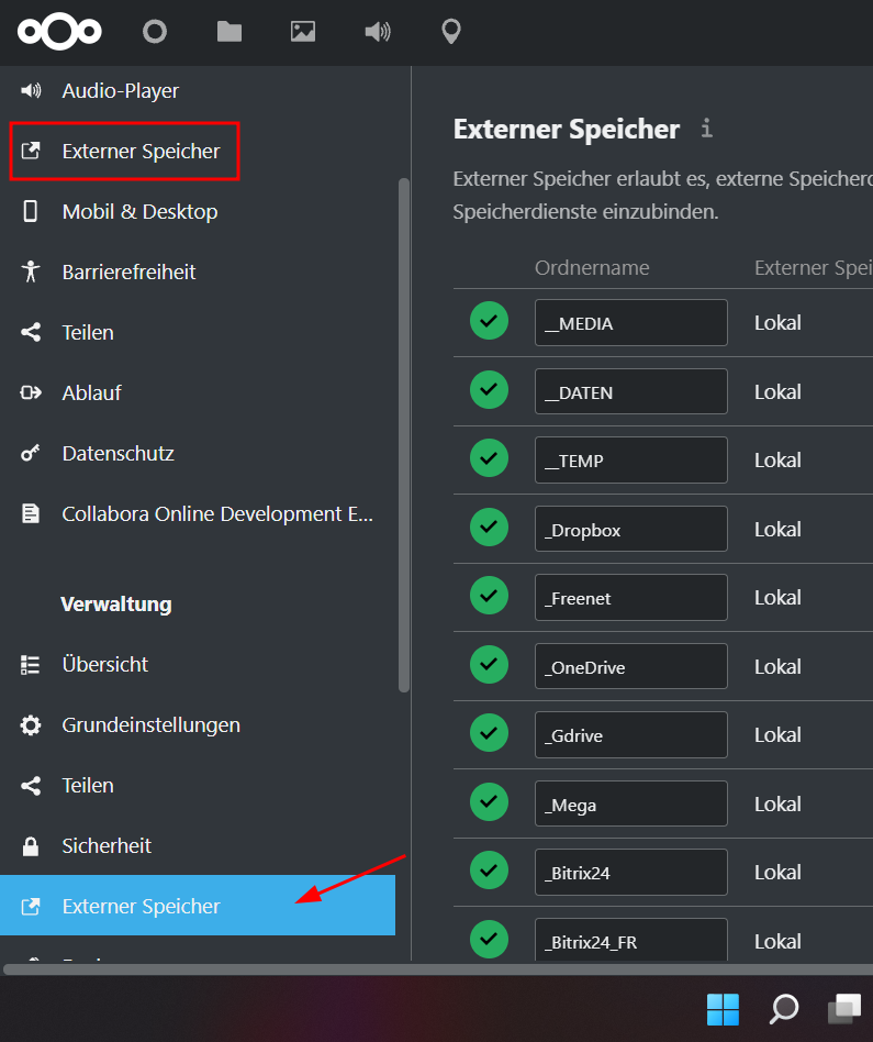

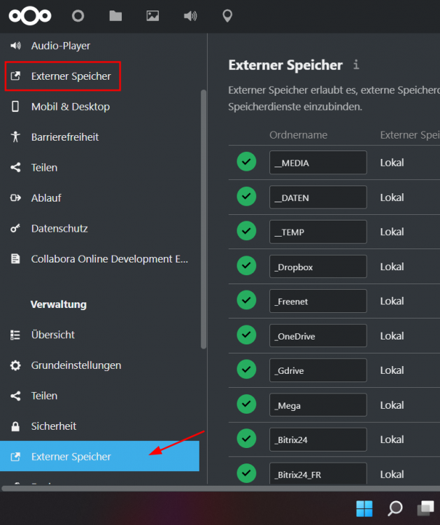

21 minutes ago, loady said:
i added a new path and named the container path /ellis and then the host path /mnt/user/xbox/OG XBOX DISK CLONE/ and then clicked add, when i go to external storage on nextcloud it says 'No external storage configured or you don't have the permission to configure them'
1st using spaces in a share or folders aint the best idea, just as general note
then in NC, settings, the buttom checkbox (red arrow) ... there you add your external storage, you sure you click there ?
i think i got it...i was using the wrong 'external storage' in nextcloud..when i went to administraion there was another 'external storage' and i added 'local' and typed /data2 and this now shows up...see below..however, space invader ones video doesnt tell you how to get an external link to the files, its using the internal IP...im so close i can taste it.

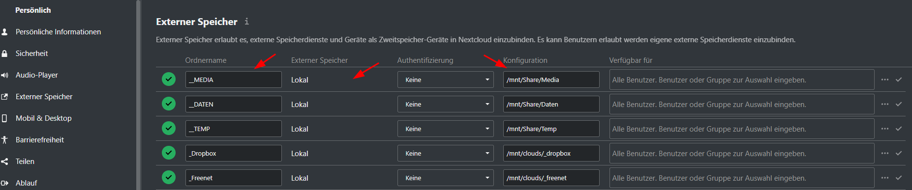

1 hour ago, Greygoose said:
It looks like your trying to do the same as me. Allow nextxloud to share another path on the unpaid system using the external storage plugin for nextcloud.
its really not so hard ... if its this what you try todo, use unraid shares in NC
mount the Share(s) you would like to add inside, sample. all /mnt/user are inside NC now as /mnt/Share
then mount them using the external storage plugin, settings (left side panel at the buttom ...)
thats it ...
thats it ...
 Thank you,
I never realised there was another setting in nextcloud admin panel
I now have it working great.
