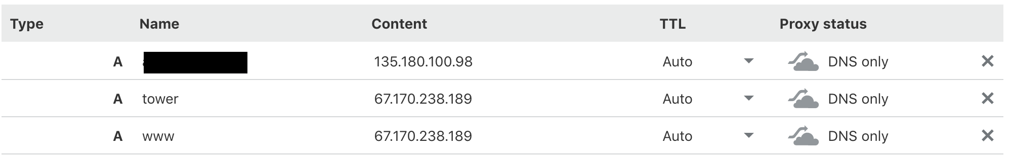

Hi everyone, my Nginx reverse proxy isn't working again. I can ping mydomain.net and I can access my external IP. I can also access my sites with internal.ip/sub.
PING mydomain.net (157.131.207.164): 56 data bytes
64 bytes from 157.131.207.164: icmp_seq=0 ttl=62 time=3.517 ms
64 bytes from 157.131.207.164: icmp_seq=1 ttl=62 time=3.480 ms
64 bytes from 157.131.207.164: icmp_seq=2 ttl=62 time=3.650 ms
64 bytes from 157.131.207.164: icmp_seq=3 ttl=62 time=3.880 ms
64 bytes from 157.131.207.164: icmp_seq=4 ttl=62 time=3.466 ms
64 bytes from 157.131.207.164: icmp_seq=5 ttl=62 time=3.857 ms
64 bytes from 157.131.207.164: icmp_seq=6 ttl=62 time=6.915 ms
64 bytes from 157.131.207.164: icmp_seq=7 ttl=62 time=3.207 ms
64 bytes from 157.131.207.164: icmp_seq=8 ttl=62 time=4.056 ms
^C
--- mydomain.net ping statistics ---
9 packets transmitted, 9 packets received, 0.0% packet loss
round-trip min/avg/max/stddev = 3.207/4.003/6.915/1.058 ms
The log doesn't indicate anything out of the ordinary:

and I checked but there aren't new updates to the container I can try (last time this happened, an update got it working).
Any ideas how I can troubleshoot here or what else I can provide for help? TIA.
EDIT: Found nginx's error.log:
2019/09/29 02:23:18 [error] 446#446: *832 connect() failed (111: Connection refused) while connecting to upstream, client: 66.249.69.19, server: _, request: "GET /robots.txt HTTP/1.1", upstream: "http://192.168.1.252:8282/robots.txt", host: "mydomain.net"
^C
_ ()
| | ___ _ __
| | / __| | | / \
| | \__ \ | | | () |
|_| |___/ |_| \__/
Brought to you by linuxserver.io
We gratefully accept donations at:
https://www.linuxserver.io/donate/
GID/UID
User uid: 99
User gid: 100
[cont-init.d] 10-adduser: exited 0.
[cont-init.d] 20-config: executing...
[cont-init.d] 20-config: exited 0.
[cont-init.d] 30-keygen: executing...
using keys found in /config/keys
[cont-init.d] 30-keygen: exited 0.
[cont-init.d] 50-config: executing...
Variables set:
PUID=99
PGID=100
TZ=America/Los_Angeles
URL=mydomain.net
SUBDOMAINS=www
EXTRA_DOMAINS=
ONLY_SUBDOMAINS=false
DHLEVEL=4096
VALIDATION=dns
DNSPLUGIN=cloudflare
[email protected]
STAGING=
4096 bit DH parameters present
SUBDOMAINS entered, processing
Sub-domains processed are: -d www.mydomain.net
E-mail address entered: [email protected]
dns validation via cloudflare plugin is selected
Certificate exists; parameters unchanged; starting nginx
[cont-init.d] 50-config: exited 0.
[cont-init.d] 99-custom-files: executing...
[custom-init] no custom files found exiting...
[cont-init.d] 99-custom-files: exited 0.
[cont-init.d] done.
[services.d] done.
[cont-init.d] done.
[services.d] done.
Server ready

WORKING NOW AFTER CHECKING CLOUDFLARE:
I also use the Cloudflare function with the container. I suspect the container is not updating my IP to Cloudflare's DDNS?
After your suggestion to connect with my external IP from my cell, I went into my Cloudflare account to take a look and realize it's pointing my domain to the wrong IP.
If I manually updated my IP in Cloudflare, everything works.
I also notice this old IP address associated with "tower" and "www":
1636356836_ScreenShot2019-10-06at5_36_07PM.thumb.png.434933337416aa62c1a9cf1d53919c57.png
67.170.238.189 is a Comcast IP and I haven't been with them since around April.
Is it possible the Cloudflare part of the container is broken?
Edited by vurt

56 minutes ago, vurt said:
Thanks for taking a look @aptalca.
http://192.168.1.252:8282/ was for Organizr which I had disabled, I had also commented out that config in my reverse proxy. I'm not sure why it's causing that error?
"Unable to connect."
This container does not update your ip on your dns provider. That's your responsibility. This container only does the domain validation through various methods (through cloudflare in your case).
Sorry for my confusion. What is the domain validation that the container is doing through cloudflare?
I had a cloudflare-ddns container runinng before but I must've turned it off thinking this container was updating my external IP with cloudflare (because the setup asked for my cloudflare API token and my associated email).
So all this time I thought my Nginx wasn't working but in reality it's because Cloudflare is no longer associating my domain with my external IP because I had stupidly turned off the separate cloudflare-ddns container?
Link to comment
It's validation your ssl certificate.
So the issue was that you turned off the container that updates Cloudflare when you get a new IP.
  • Thanks 1

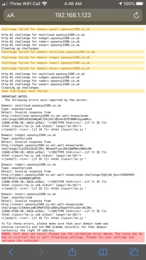

I have my own domain through google and a static Ip for my server. I am following spaceinvaderone guide to set up let'sencrypt and when I check my log files like he says and all my subdomains come back with
Error: Challenge failed for domain my.example.of.domain
Then further in the logs files under important notes it says no valid ip addresses found for each sub domain.
Link to comment
I'm a newbie too but here are a few things I had to check when I set this up a couple of months ago.!
Have you set up your google domain records to point back to your static IP address?
I used cloudflare as per the excellent spaceinvader tutorial and all works fine with dns validation.
Check that you have set the top level domain name in the letsencrypt container settings. i.e. if your domain is 'example.domain' and you are creating a certificate for the subdomain 'my.example.domain' then the docker container setting for domain name would be 'example.domain'
Also make sure your router/firewall is forwarding traffic, so from your router/firewall port 443 should be forwarded to your local unraid server ip address port 1443 or whatever port number you specified in the docker container settings under 'https'
Hope that helps
Link to comment
10 minutes ago, Alec.Dalessandro said:
I have set the domain name in the container to my domain. Following your example I set it to 'example.domain' and I have set the port correctly to the forwarded ports for http and https.
I guess the only thing I am missing is to set my google domain records to point back to my static IP. Would that be what cloudflare is doing?
See here:
https://blog.linuxserver.io/2019/04/25/letsencrypt-nginx-starter-guide/
And here:
https://blog.linuxserver.io/2019/07/10/troubleshooting-letsencrypt-image-port-mapping-and-forwarding/
Link to comment

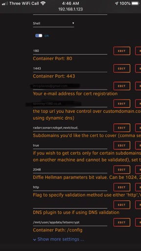

I’m having trouble with let’s encrypt it was working fine but I have just changed isp that does not include a static up.
Setup Cloudflare dns and Cloudflare points to my IP address I have a file and a www. That points to ip
Let’s encrypt says it’s not correct at Cloudflare it doesn’t have a or cname it does
Link to comment
