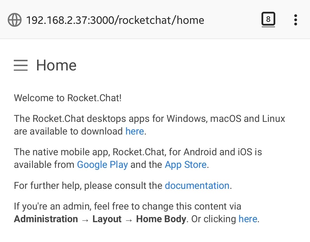

Hi, first I'd like to thank you for all great work and support of this docker.
I use 7 Dockers to access it from Wan perfect.
Now I try to setup Rocketchat docker bit I can't find the Rocketchat.subdomain.conf file in the folder in Let'sencrypt.
Is it possible to use another Subdomain.conf file and just to change the name to Rocketchat or please give me some advice.
Sorry,i haven't very good skils in this.
Thank you, very much.
Sure, you can copy another one and modify as needed
Link to post
Thank you.
I created conf. and the let's encrypt start with Server ready no errors.
Then I edit MongoDB and Rocket.chat network type I put them like all on Proxynet and everything broke I get errors in both containers in Logs and they can't start anymore.Then I put them back on Bridge but still broken logs.I delete them and give up.😃
I will wait someone one day to make a good tutorial for Rocketchat .
Thank you for the fast answer and great work.👍
