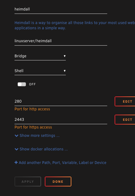

I'm sure I'm setting something up wrong here. I've set up my reverse proxy through Spaceinvader One's excellent tutorial on how to set up Nextcloud and how to have it visible over the internet.  (which I've gotten other containers visible over the domain URL, however, they do not use 80/443, such as Ombi)
I'm sorry I need to preface this as I'm not super skilled in this realm. If you're asking me to do something, explain like I'm five.
The issue I have is trying to get heimdall visible over the internet through my subdomain server.myserver.com
However, when I try to access that I get the Letsencrypt's welcome screen. However, If I place the port I opened up in the firewall  at the end of the domain URL I can get in. It appears I need some way to make the system know which port to direct me to automatically, which I'm not sure how to do.
I obviously changed the default ports from 80 and 443 as these are already used.
The only change I made to heimdall.subdomain.conf file is to change it from heimdall.* to server.*
Edit: not sure what I did other than remove the information for port 80 in the container edit screen and left 443's port
You should not have to open a port in the firewall, your reverse proxy should pick up the request on 443 and send the request to the heimdall's port.  That is the whole point of a reverse proxy, to block your internal ports from direct access from the internet.
It seems you need to configure heimdall in the letsencrypt config folder.  Take a look at the samples the linuxserver team already has ready:  https://github.com/linuxserver/reverse-proxy-confs

hey guys, read through the thread here and saw folks dealing with a few reverse proxy problems, but didn't see a solution for me. i've kept my setup fairly simple with a custom domain "mysite.com". i've got no issues getting this to work for other cname instances, but can't seem to get it working for heimdall. i'm using linux's letsencrypt default subdomain config:
# make sure that your dns has a cname set for heimdall
server {
    listen 443 ssl;
    listen [::]:443 ssl;
    server_name heimdall.*;
    include /config/nginx/ssl.conf;
    client_max_body_size 0;
    # enable for ldap auth, fill in ldap details in ldap.conf
    #include /config/nginx/ldap.conf;
    # enable for Authelia
    #include /config/nginx/authelia-server.conf;
    location / {
        # enable the next two lines for http auth
        #auth_basic "Restricted";
        #auth_basic_user_file /config/nginx/.htpasswd;
        # enable the next two lines for ldap auth
        #auth_request /auth;
        #error_page 401 =200 /ldaplogin;
        #include /config/nginx/authelia-location.conf;
        include /config/nginx/proxy.conf;
        resolver 127.0.0.11 valid=30s;
        set $upstream_app heimdall;
        set $upstream_port 443;
        set $upstream_proto https;
        proxy_pass $upstream_proto://$upstream_app:$upstream_port;
here's a screenshot of my container config:
i've got heimdall setup and working just fine on lan, just can't get it on the reverse proxy side. during troubleshooting, i tried changing upstream to match the container 2443:
set $upstream_port 2443
but it didn't make any difference, so i reverted back to default 443 until i get some guidance. i've triple checked my cname in cloudfare at heimdall.mysite.com.
Any help is much appreciated, thanks!

See here https://blog.linuxserver.io/2019/04/25/letsencrypt-nginx-starter-guide/
