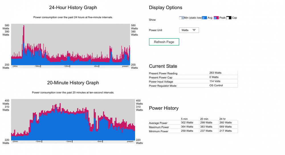

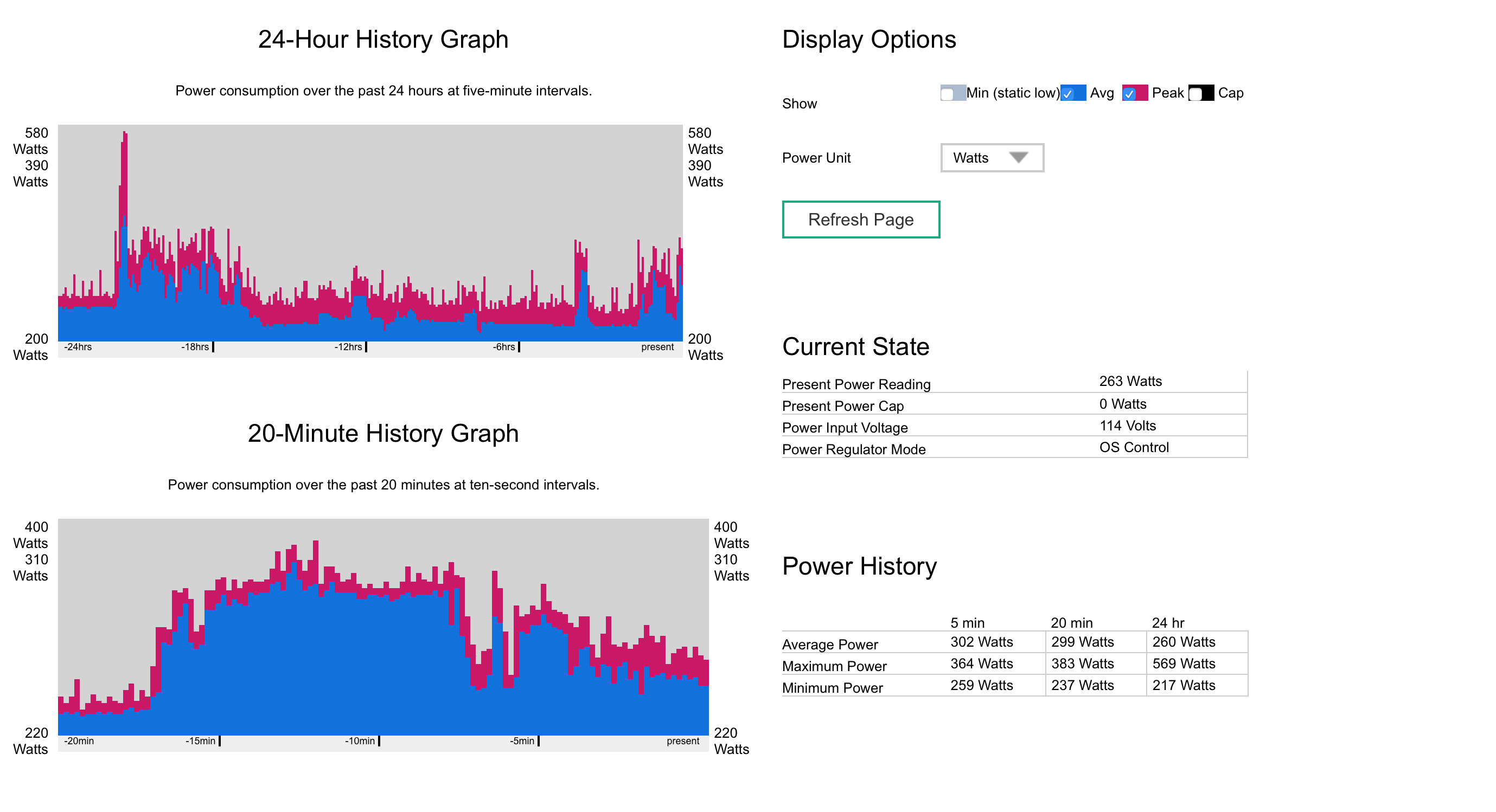

October 2, 20206 yr I think I win... or lose... overnight "idle" low is about 217 watts. But it's never really at idle.That includes: 2 8 core processors (32 threads) 128 GB ram 5 disk main array in various states of spun up and down 7 disk backup pool spun down 2 SSD cache up 4 SSD pool up 1 vm running with 2 rx580's and some various dockers contributing to a few watts here and there.

July 26, 20215 yr On 10/2/2020 at 7:31 PM, 1812 said: I think I win... or lose... overnight "idle" low is about 217 watts. But it's never really at idle... Nice Graphs - what exactly is this or how do you measure these values? Edited July 26, 20215 yr by Zonediver
July 27, 20215 yr 18 hours ago, Zonediver said: Nice Graphs - what exactly is this or how do you measure these values? It's generated by HP's server management system iLO.
