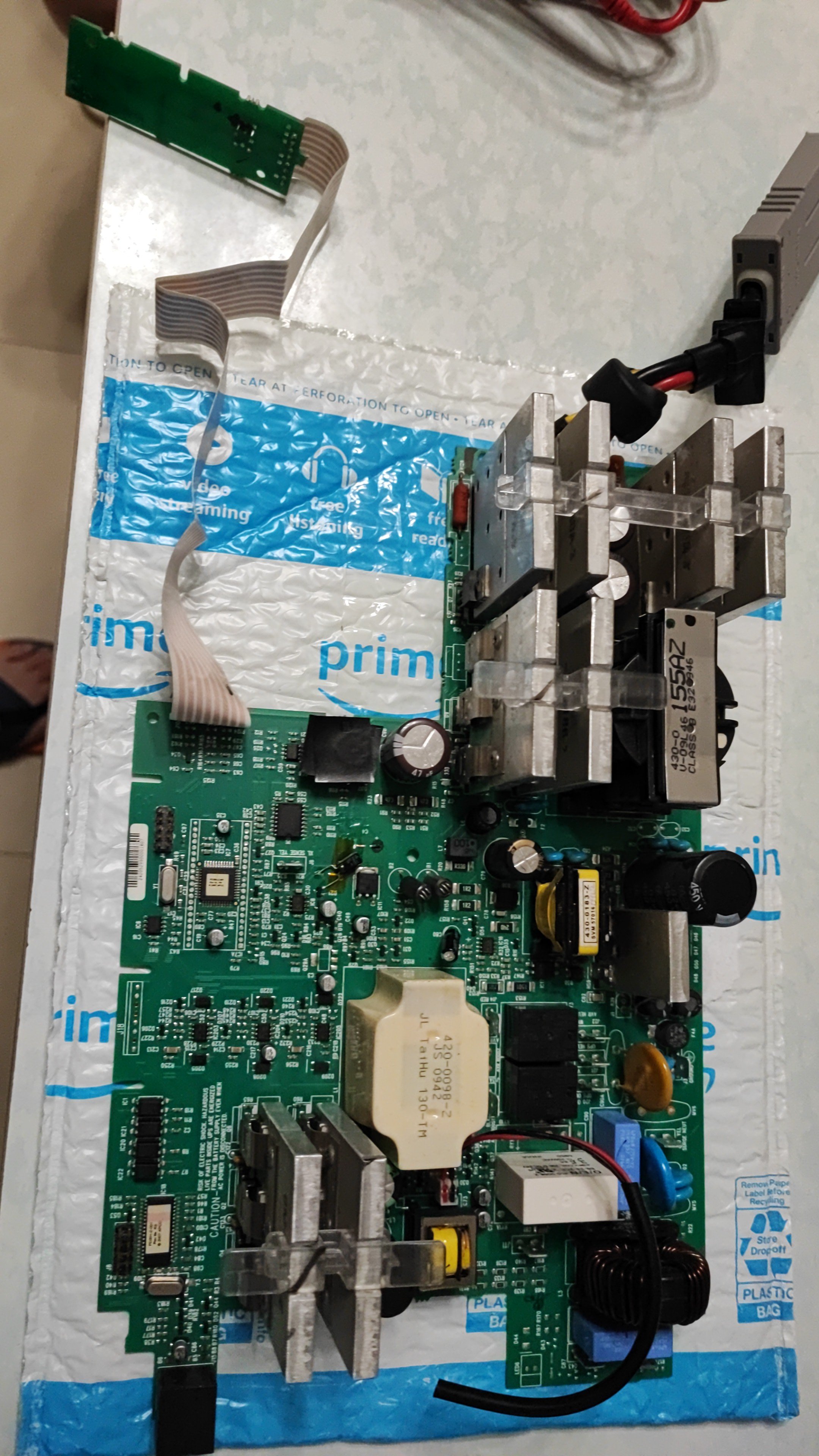

  19. Yeah, my last two UPS also come from those channel, 2200va (free, battery dead only)and 1500va (20usd, battery dead and need electronic troubleshoot ) Below is the 1500va one, I finally remove the bulk AVR transformer because I don't need AVR function as switching PSU are wide voltage support, its weight reduce to less then 2kg without battery.
