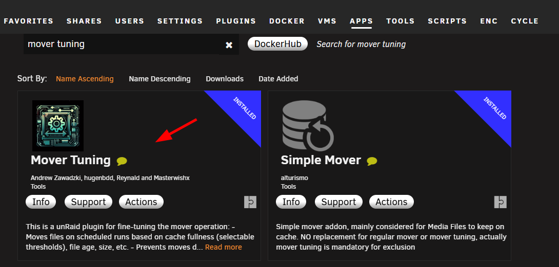

  16. yes it has 2 purposes 1/ cache mover, yes, to delete the cached file after keep hours (the plugin makes a copy, doesnt move anymore and moves back afterwards, that changed a while ago as i wanted to avoid a 2nd spinup when moving back and FUSE can handle it properly with a copy on cache ssd) lets call it cache mover "working list" 2/ for mover tuning to ignore the "cached" files, otherwise may the files are wiped when mover runs. so the file path should be setted to the mover tuning exclusion list path, sample mover tuning cache mover so my plugin will add / remove those files from the mover tuning exclusion list. add when a file is cache, remove when done (wiped again from cache)
