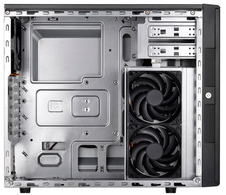

  9. I have had the case for 5 years and have never had an issue with the backplane connections. The Molex connectors that supply power to the HDD cages fit tightly. The SATA cables for each drive do stick out a bit as do some capacitors on the back of the cages. Just be careful when working in the case and there are no issues. As far as the hot swap connections for the HDDs inside the HDD cages, they seem solid and secure and I have never had a probem when inserting or removing an HDD in the hot swap bays.
  10. I have this case and don't think this would be easily possible. There is not much room between the top of the 8 HDD hot-swap cages and the existing 5.25" bays. if you cut everything out above the HDDs to the top of the case and made your own bracket for a 3x3.5" it might just fit. Depends on what 3x3.5" (or even 5x3.5") unit you choose. I measure about 5.125" of space between the top of the HHD bays and the top lip of the case.
