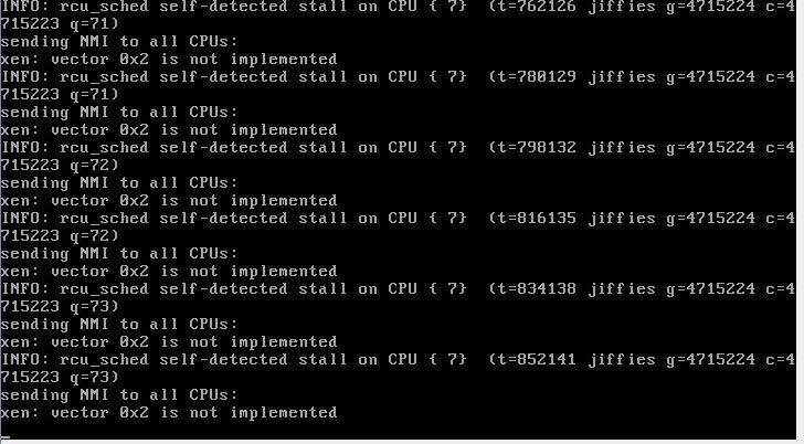

I got a nasty crash today. Was running 5a stock and ArchVM 4.0, with some disk intensive addons running on the cache drive only (array disks are configured but not being accessed). The cache drive was accessed via an NFS share (/net/Tower/mnt/user...). Had been running stable for several days.
This morning I woke up to an unresponsive server. Thanks to IPMI I was able to capture the dying console and reboot the machine from 500 miles away! (Very cool!) Maybe not many hints but thought I would post what I had. By the way, even from the console I was not able to get to a command prompt. I executed a computer reset and poweron via IPMI and it came up fine and has been running stable all day under high I/O usage, getting that funky error message on the VM's console (xennet: skb rides the rocket).
Although I might understand that the vm OS might crash running the addons, the crashing vm should not have brought down unRAID and the entire box.
Only time I have had that exact error is when I have pinned cpus to dom0 in syslinux.cfg. I pinned 2 cpus and allocated 4-7 in the vm
I got a nasty crash today. ...
This has already been experienced and reported by several people.  It is believed that the new kernel, to be included with b6, will fix this.
In the meantime, several of us have pinned one, or more, cpu to Dom0, and not experienced the problem since.
hi bjp999, just to echo peter's comments, there have been a number of people seeing the exact same crash, peter and myself included, the workaround is pinning a number of cores to dom0 and excluding these cores from your domU's, this for me has completely stabilised my system, i was seeing crashes at around the 4-5 day mark, now with the pinning in place i have an uptime exceeding 20 days, so im fairly confident this seems to get around this particular issue.
my theory (which could be completely wrong!) as to why its happening is cpu starvation of dom0 due to heavy cpu usage in domU's, thus casuing the xen process to not have enough cycles to process requests and causing the whole thing to collapse, bringing down domU's and dom0, pinning of course alleviates this by guaranteeing enough cpu time in dom0 to process xen commands, plausible?.
there is a post linked below which seems to point at a later kernel potentially fixing/debugging the issue, i think its def worth looking at the issue again once 6.0-beta6 is released, as both kernel and xen version will be later versions, link to xen post:-
http://lists.xen.org/archives/html/xen-devel/2013-10/msg00585.html

I was just trying to pin cores for performance reasons. But pinning cores crashes my server but helps others who crash with default. I can run stable with default syslinux.cfg.  Right now I just have 4GB allocated to dom0.
running pinned caused you issues because you hadn't excluded the pinned cores from your domU's, this in turn makes the cpu starvation issue more prevalent, as your then restricting dom0 to only 1-2 cores and at the same time still using those cores in your vm's.
