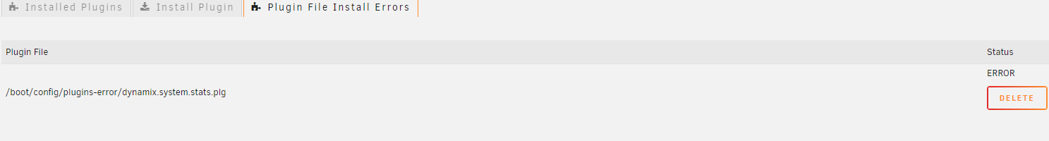

I need to install the plugin but I cannot find the old version and the previous version from my flash doesn't work. The reason for this is that I installed the new version and then I had to downgrade because VPN was not working. Now I'm stock without the stats.
This is the error I get
plugin: installing: /boot/config/plugins-old-versions/dynamix.system.stats.plg/2018.08.29a/dynamix.system.stats.plg
plugin: downloading: https://raw.githubusercontent.com/bergware/dynamix/master/archive/dynamix.system.stats.txz ... done
plugin: bad file MD5: /boot/config/plugins/dynamix.system.stats/dynamix.system.stats.txz
