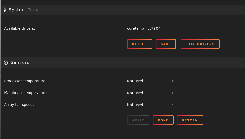

On 6/3/2018 at 3:18 AM, Auxilium said:
I and at least one more person have problem with System Temp,
sensors output:
root@SERVER:~# sensors
Error: File /etc/sensors.d/sensors.conf, line 2: Undeclared bus id referenced
Error: File /etc/sensors.d/sensors.conf, line 4: Undeclared bus id referenced
Error: File /etc/sensors.d/sensors.conf, line 6: Undeclared bus id referenced
Error: File /etc/sensors.d/sensors.conf, line 12: Undeclared bus id referenced
sensors_init: Can't parse bus name
/etc/sensors.d/sensors.conf content:
# sensors
chip "nct7904-i2c-0-2d"
ignore "fan2"
ignore "fan4"
ignore "fan5"
chip "coretemp-isa-0000"
label "temp1" "CPU Temp"
chip "i350bb-pci-0500"
label "temp1" "MB Temp"
label "fan8" "Array Fan"
It is with SuperMicro X9DA7 motherboard, and also X9DRi-LN4F+ (the other person on DataHoarding Discord)
BLKMGK here have same problem: https://lime-technology.com/forums/topic/29533-dynamix-system-temp/?do=findComment&amp;comment=657577
According to https://linux.die.net/man/5/sensors3.conf
what is missing is bus statement,
in my case it's
bus "i2c-0" "SMBus I801 adapter at 9000"
After that everything works.
This literally saved me! Thanks!
Do you know if the CPU temp is combining CPU 1 and CPU 2 temps or is it something different?
Edited by Tech4KStudios
