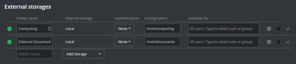

45 minutes ago, StanC said:
For myself I used the External storages 1.4.1 app to share two unRAID shares that I have outside of Nextcloud storage.
I've got the External Storages app going but I'm having a hard time getting the shares to hook up to the server, can you share an example of how you configured one? Thanks!!!

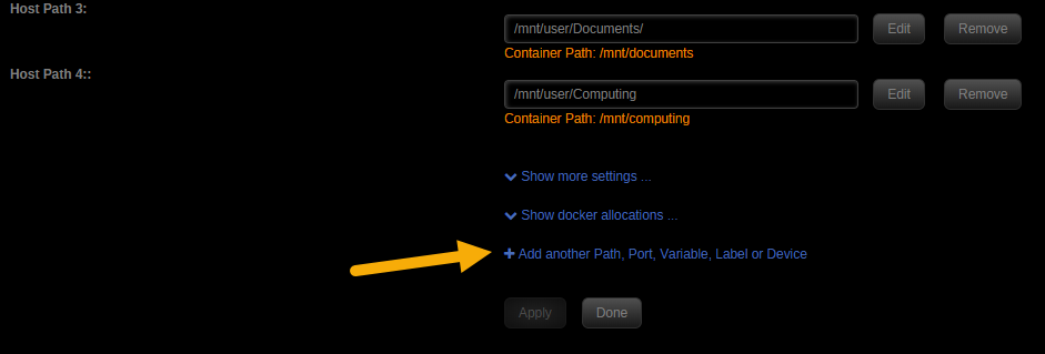

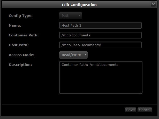

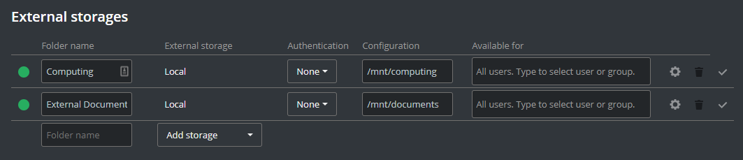

Yes, what I did was for my Nextcloud docker was add my two external storage paths as additional mounts inside the docker by clicking on "Add another Path, Port, Variable, Label or Device":
Then enter my details:
Then once I had them entered, go back to External Storages app and added them there.
Share this post
