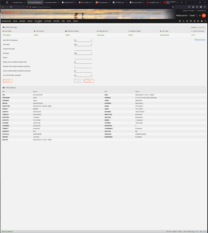

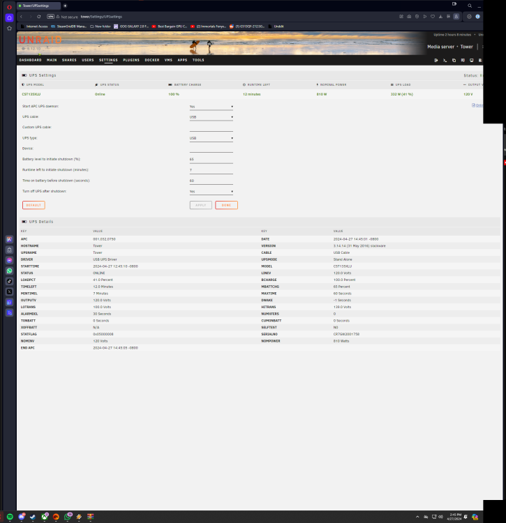

  • Your shutdown occurred within a few minutes.  It doesn't seem like the timers worked at all.  Double check the settings.   Your shutdown timer is set to 60 seconds. Your VM timer is set
