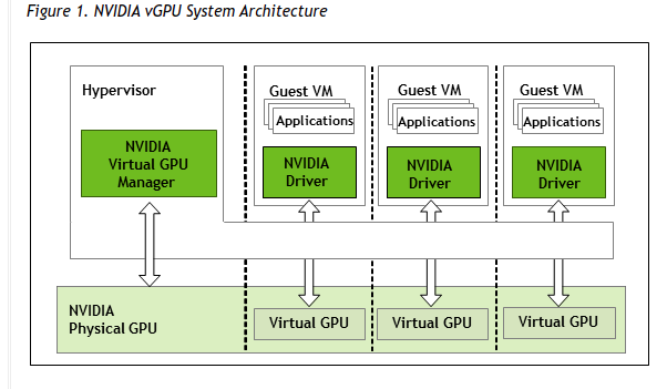

I am also interested in taking 1 GPU, virtualizing it into multiple vGPU resource pools then sharing those pools to different VMs.
For example... 10GB Card split into 10 x 1GB vGPUs to be shared across 10 windows VMs each thinking they have their own discreet 1GB GPU.
Is this possible now on unraid?
The RTX 3000 cards supposedly support SR-IOV from a hardware point of view.
But Nvidia will need to enable it (they won’t as it’s an enterprise feature).
Unraid would also need to support it. Although cool to have 1 GPU and to split it up. It’s a very fringe case.

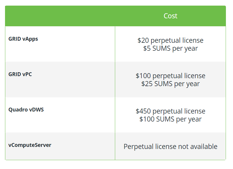

I believe this is worth investigating.  The GitHub has an explanation on how to do it.  (I'm just not technical enough to figure it out...)  You do have to pay for the vendor licensing after 90 days.  So worth a shot to try it out and see if worth it.  The cost of entry isn't that high either... $100+ $25 a year.  I know it would save me buying a more expensive motherboard...
