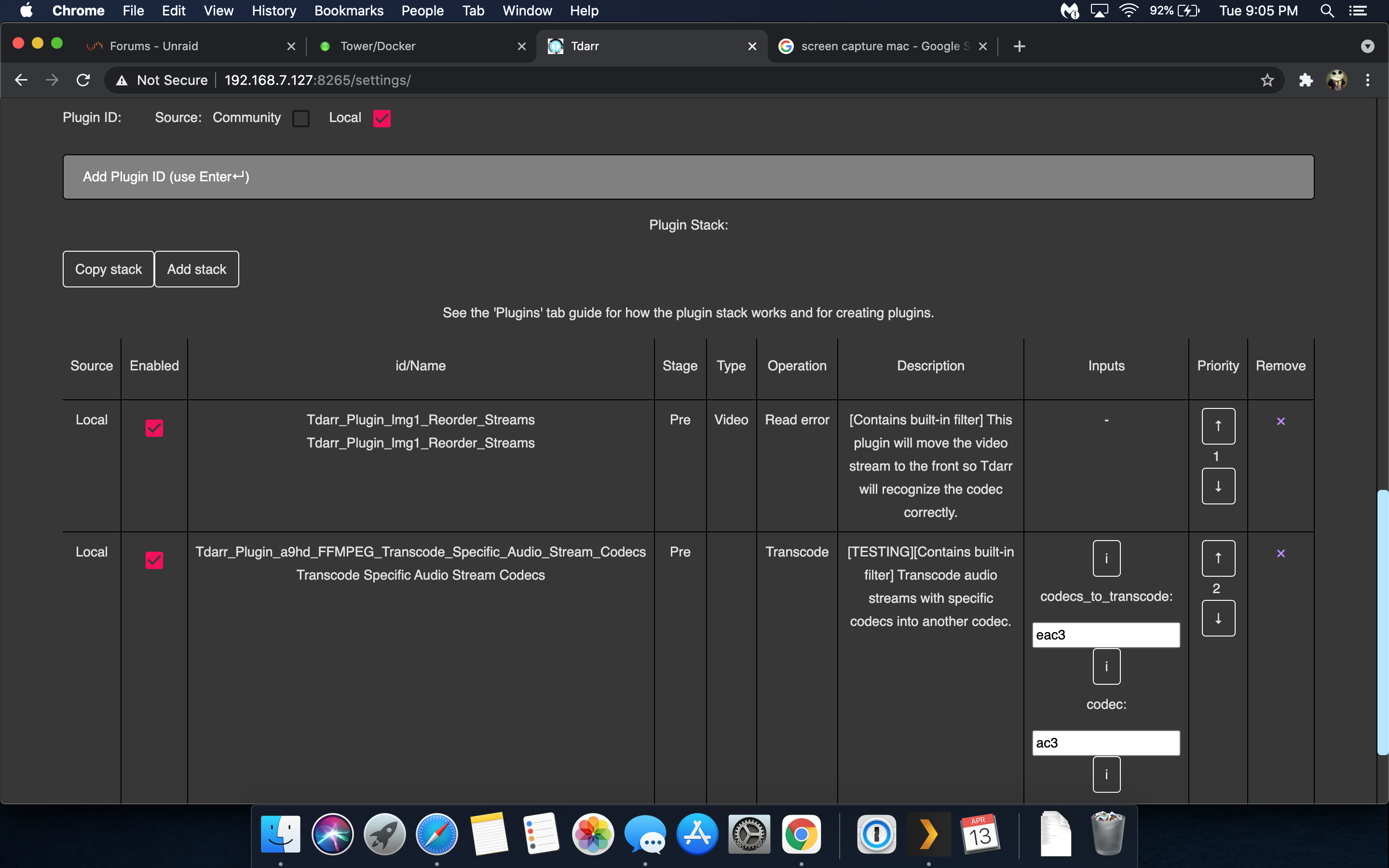

using V1 tdarr_aio I was looking at my plugins via the library under Transcode Options and some of them say "Read error". They are all still in the Local Folder. Should I be worried? So I if I check the Community button vs the Local the error goes away until I return then it says Invalid Plugin in purple under the search field. All my Plugins ID's where copied from the local folder and I made sure the Local folder was selected when I added them the first time. I just don't know what is going on now thou. Everything seemed to be just fine until I clicked the update community Plugins.
