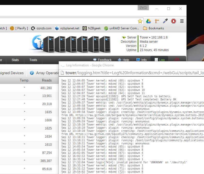

Not sure if this belongs in this thread or general support, but I noticed under 6.1.2 that the log display through the UI seems to just hang and most of them time never displays.  I tested this on both of my upgraded unraid servers and it does it across both.
On Dashboard, under System Status, where it says "flash : log : docker" what is the percent used for log, the middle number?
It shows 9% on both servers.
I've noticed the same thing, however although I'm not 100% certain, it seems to me I had the same problem on 6.1.1
And it's not most of the time, I've never gotten the logs to work.
And for what it's worth, my log percentage on the status page is 22%
Are you blocking popups?
verified working here using Chrome v45.0.2454.85 m, on 6.1.2
Yes. Logs are working here in Chrome too in Windows 10. Also in the Edge Browser. And in Internet Explorer.
