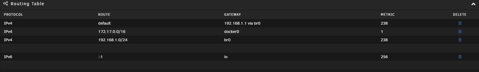

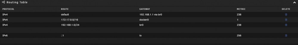

I've ran pi hole in docker, which worked great. Now a couple of weeks ago, it stopped working after a restart and I don't know what happened. It comes down to Unraid server is running dnsmasq and keeps UDP 67 busy. I didn't upgrade so it must be settings of VM related I guess. Stopped all docker apps but that didn't help.
"listen udp 0.0.0.0:67: bind: address already in use."
Unraid version: 6.8.3
netstat -nlp | grep "0.0.0.0:67"
udp        0      0 0.0.0.0:67              0.0.0.0:*                           4326/dnsmasq

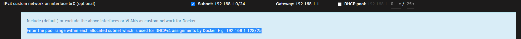

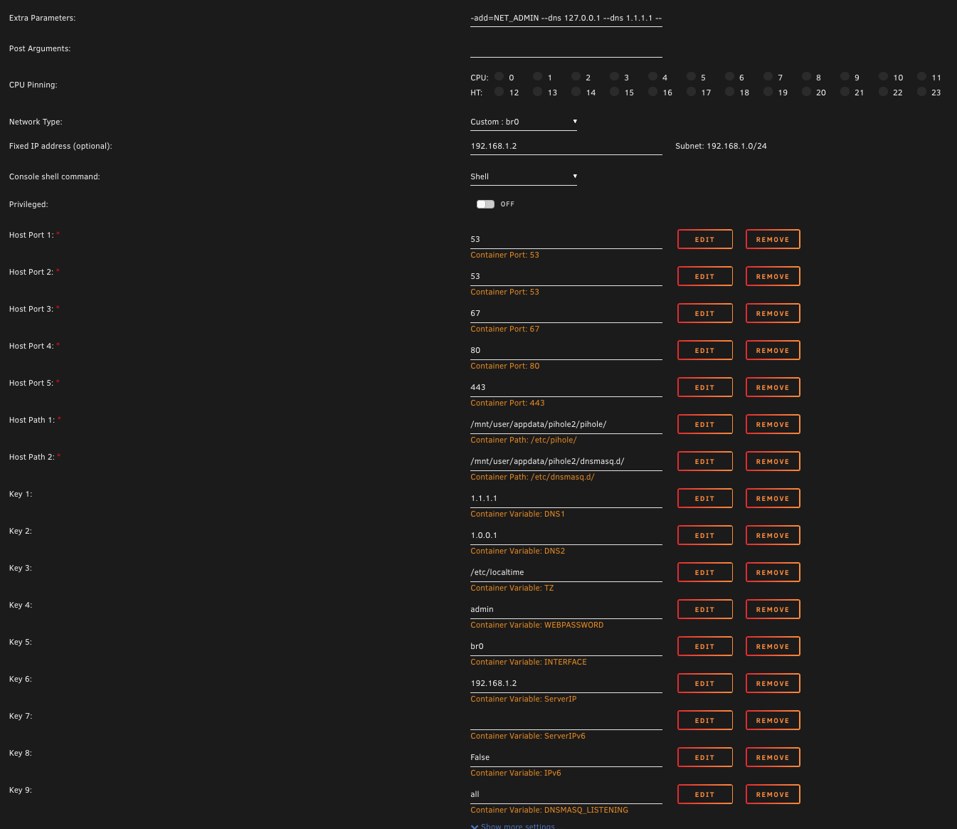

Can someone with the "custom:br0" please run:
docker network inspect br0
and post the contents here, then I can just recreate it :)

But all you need to do is enable the option in docker settings (advanced view with the service disabled)
Well, that is strange. I needed to stop docker in order to see that setting (might have missed that before, not sure). But it was already checked. Unchecked it and rechecked it, then started docker again and yes it is visible now :)
Thanks! Now see if I can configure pihole :D
edit:
and yes, pihole seems to work perfectly now! thanks again!

Having trouble getting this to start. I have experience both with docker containers on Unraid as well as pihole running on other systems (pis, hyper-v).
On startup, it's getting stuck at the following point in the log shown below. I can't get the web console to work.
Starting crond
Starting pihole-FTL (no-daemon) as root
Starting lighttpd
Here's what I've tried so far:
  • chmod 777 on the appdata folder
  • Tried both latest version and v4.3.4
  • Privileged and unprivileged levels
  • Verified that the IP shows up on my network (I can see the client in Unifi)
  • Removed the default extra parameters from the template
Here's my full docker run command.
root@localhost:# /usr/local/emhttp/plugins/dynamix.docker.manager/scripts/docker run -d --name='pihole' --net='br0' --ip='192.168.1.32' -e TZ="America/New_York" -e HOST_OS="Unraid" -e 'TCP_PORT_53'='53' -e 'UDP_PORT_53'='53' -e 'UDP_PORT_67'='67' -e 'TCP_PORT_80'='80' -e 'TCP_PORT_443'='443' -e 'DNS1'='1.1.1.1' -e 'DNS2'='1.0.0.1' -e 'TZ'='America/New_York' -e 'WEBPASSWORD'='supersecret' -e 'INTERFACE'='br0' -e 'ServerIP'='192.168.1.32' -e 'ServerIPv6'='' -e 'IPv6'='False' -e 'DNSMASQ_LISTENING'='all' -v '/mnt/disk1/appdata/pihole1/pihole/':'/etc/pihole/':'rw' -v '/mnt/disk1/appdata/pihole1/dnsmasq.d/':'/etc/dnsmasq.d/':'rw' --cap-add=NET_ADMIN --dns 1.1.1.1 --dns 1.0.0.1 --restart=unless-stopped 'pihole/pihole:latest'
Any tips on what to try?
Edited by bigmak
what is the server IP and the Pihole ip?
Server is .244, pihole is .32 set through br0. I can see on my router (unifi) something at .32 has reached out to the router.
