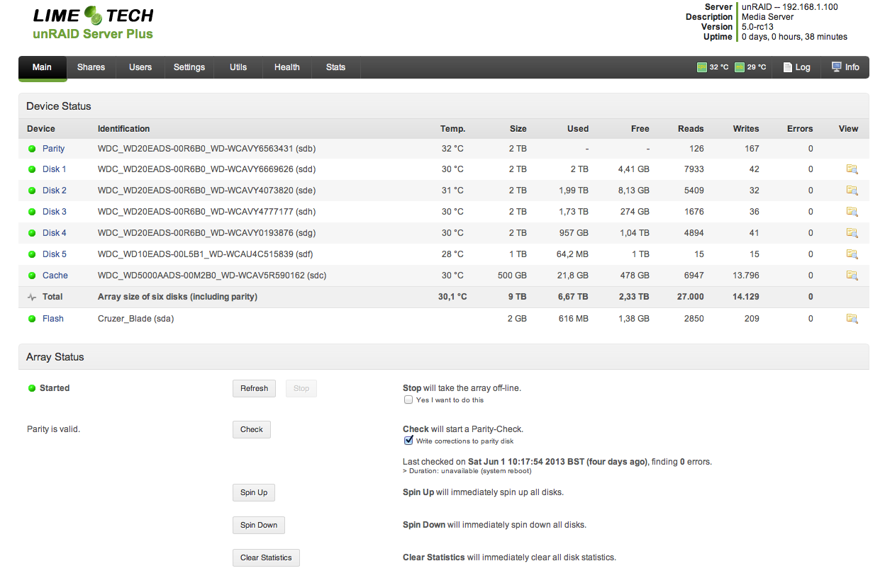

I'm getting higher than normal processor activity (jumping to 10-20% every other second) when the server is 'idling' and there seems to be higher than normal writes to my cache drive too... 10.695 after rebooting the server 27 mins ago and increasing by roughly 5 every 2-3 seconds (thats after a reboot and doing nothing else other than auto initialising PLEX, Sab, CP and SickBeard).
I know its not a 'stock' test, but its something that defiantly wasn't happening with rc12, so i just wanted to mention it (its not causing me any visible problems).
Rich
I'm getting higher than normal processor activity (10-20% every other second) when the server is idling and there seems to be higher than normal writes to my cache drive... 10.695 after rebooting the server 27 mins ago and increasing by roughly 5 ever 2-3 seconds (thats after a reboot and doing nothing else other than auto initialising PLEX, Sab, CP and SickBeard).
Rich
only cache drive writes increasing? I wonder if not related to sync issue... but that one seems to increase on all disks...
Rich

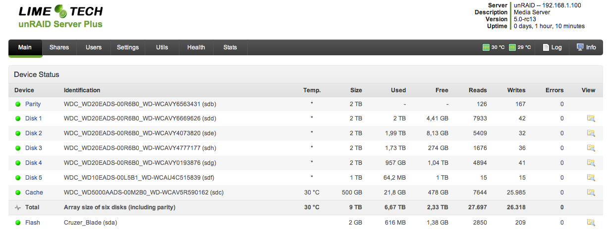

... and as a comparison
Unfortunately I've got a regression of performance!!! AFP is for some reason, utterly terrible.
Tests to the cache drive.
Restarted, then run the tests 3 times (as to confirm results from screenshots!) via AFP then 3 times via SMB. Stock install.
12a AFP
12a SMB
13 AFP
13 SMB
