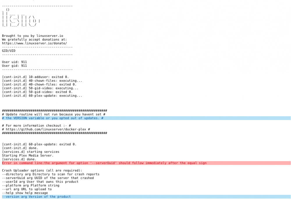

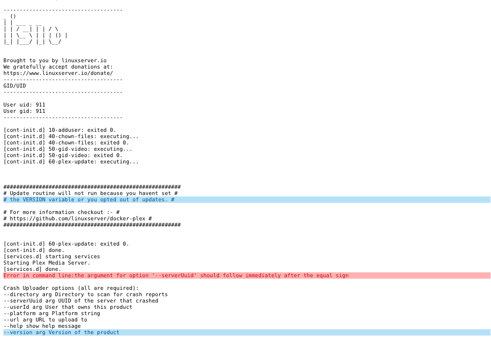

I recently upgraded my setup and stated to play with unraid so i got mostly everything setup except for the life of me i can not seem to get plex to upgrade to to most recent plexpass version. i have changed the VERSION variable to every option and it still stays at 1.14.1.5488 , i have it all setup and running. not sure what im doing wrong but can anyone point me in the right direction
