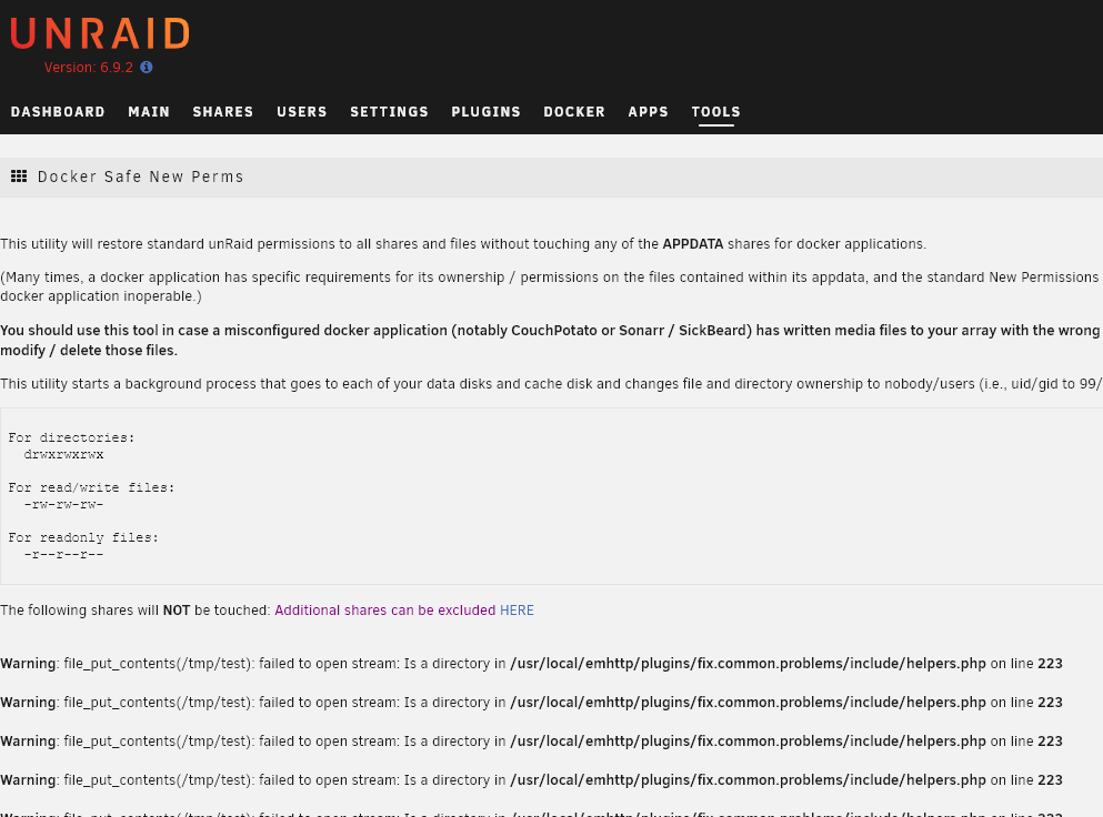

Found this on the Docker Safe New Perms page (6.9.2):
Warning: file_put_contents(/tmp/test): failed to open stream: Is a directory in /usr/local/emhttp/plugins/fix.common.problems/include/helpers.php on line 223

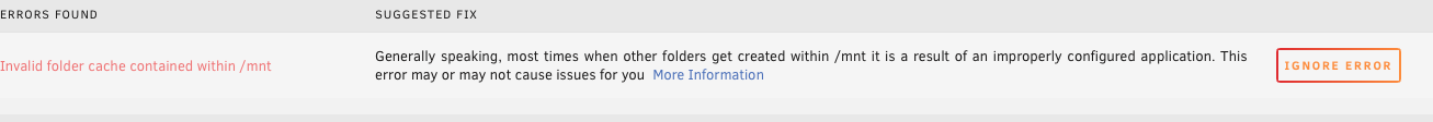

I have this error after moving the apps folder from one cache to another. The old cache is removed.
How can I fix?
Cheers,
maxx-diagnostics-20230404-1358.zip
And thats the problem.  Odds on you have a docker app (or the default appdata share in settings - docker) directly referencing /mnt/cache in one of the paths.  They need to be looked at and updated appropriately
No dockers are having a path to the old cache pool. Their path are either /mnt or /mnt/user. But in path settings the old cache "cache", is still in the list after removing the pool.
Edited by frodr
Spelling
Have you rebooted since changing the pools around?   If not then that could mean that the /mnt/cache folder is left over from before you had things reconfigured.    If it re-appears after a reboot then there is still something set with that as the start of the configured path.
Yes, I have rebooted. After doing it once more, the error message was gone. I also removed DirsyncPro docker. This docker app folder reappeared in the old Cache Pool (when it was there, but not removed) after I moved the app folder to a new Pool.
SOLVED!

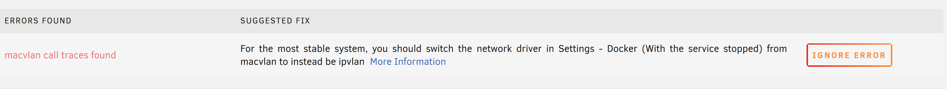

I'm getting this warning even after making the recommended change in Docker Settings
Sorry - just did a reboot and no longer getting this warning
I got this macvlan error too and not sure if it's a simple matter of changing that option in the Docker settings area.
Did you have to recreate the vlan after making this setting change so it uses ipvlan instead of macvlan?
Edited by nraygun
