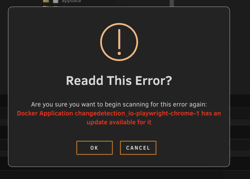

When clicking the "MONITOR WARNING / ERROR" button in the ignored list.
The pop-up has the word "Read" spelt "Readd".
Thank you for the great plugin!

Isn't that for "Re-add" as in add back in?

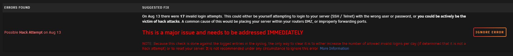

I just recently took some of the steps located on https://unraid.net/blog/unraid-server-security-best-practices. Is there anything else I should do? Any advice will be greatly appreciated. Thanks.

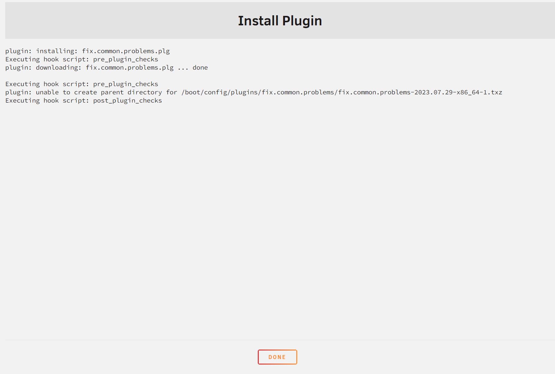

Yesterday, it was working then today it just stuck on this. Anyone having the same experience? image.png.dd24b79f0eb2d2a5f26163dd2c3c394e.png

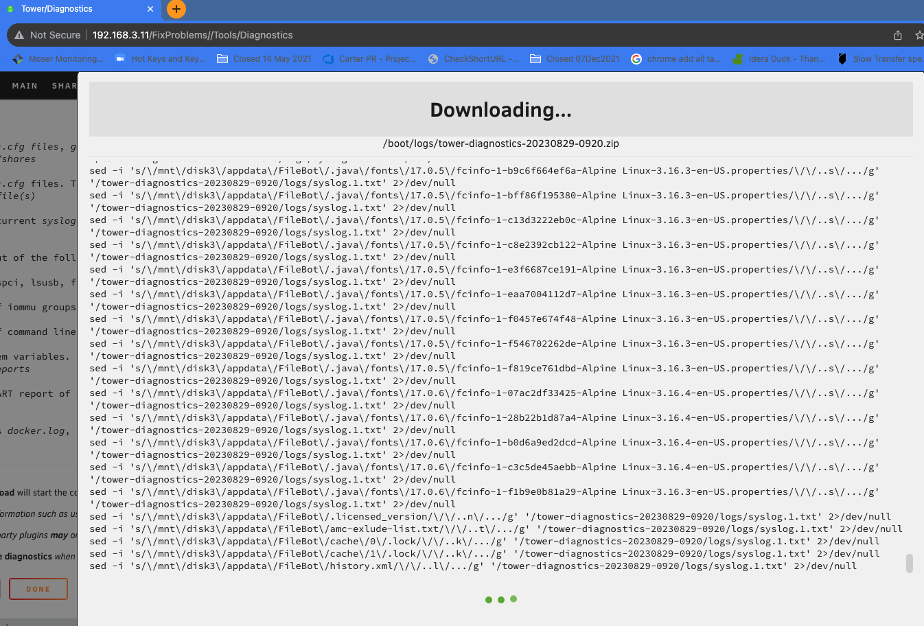

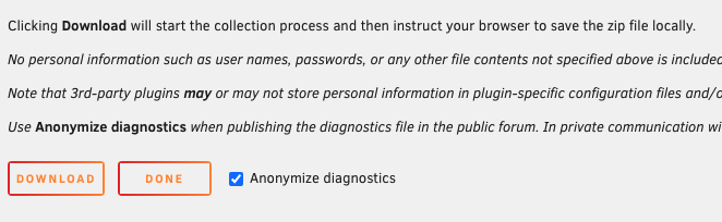

I tried to run a diagnostic report and it seems to have filled my /var/log directory.
I'm not linux smart but it appears to be enumerating every file on my server.  The report/download has been running all day so far.
is this how it should be working?  Is there anything I can do to get the report to kick out instead of filling up the directory and then bombing?

That is the logic trying to anonymise the diagnostics.    You should be able to get it to complete by switching off the anonymization, although then you need to be more cautious about posting them publically, and should probably only PM them to selected helpers.

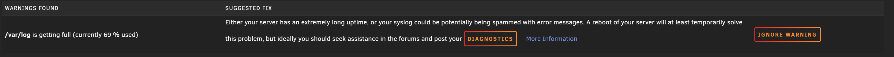

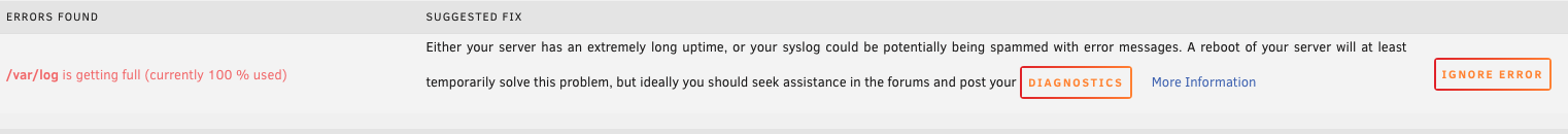

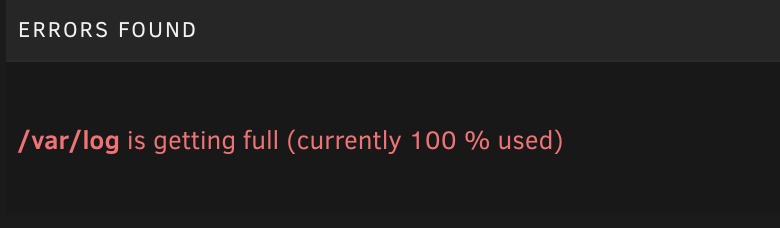

/var/log is getting full (currently 100 % used)
Either your server has an extremely long uptime, or your syslog could be potentially being spammed with error messages. A reboot of your server will at least temporarily solve this problem, but ideally you should seek assistance in the forums and post your   More Information
Looking online I found a terminal line
find /var/log/ -printf '%s %p\n'| sort -nr | head -10
The results were:
72884224 /var/log/syslog.1
58486784 /var/log/nginx/error.log.1
2449408 /var/log/unraid-api/stdout.log
122880 /var/log/samba/log.rpcd_lsad
77359 /var/log/dmesg
61440 /var/log/samba/log.samba-dcerpcd
24576 /var/log/libvirt/libvirtd.log
15496 /var/log/docker.log
10291 /var/log/libvirt/qemu/Windows 11.log
6912 /var/log/wtmp
razz-diagnostics-20230903-2219.zip
Edited by razzellu
The issue after many, many trial and errors, was keeping my unRAID page open on two windows machines.
I have an exact same issue. I'm on 6.12.4. No update of the app available.
I go to click install an get nothing.
If I go to installed plugins it does not show  up. What am I missing?
*edit* got it to work for some reason the USB drive switched to read only. Now I have it installed.
And today the issue is suddenly gone. Strange.
