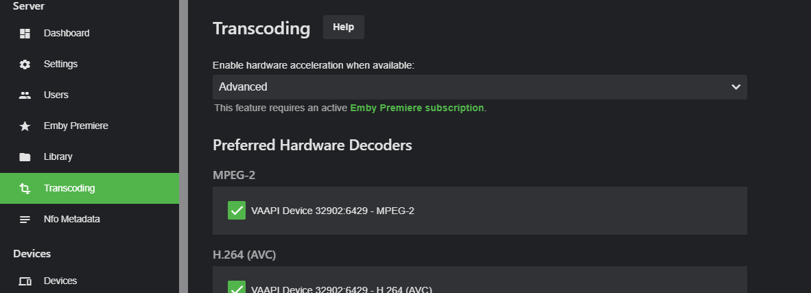

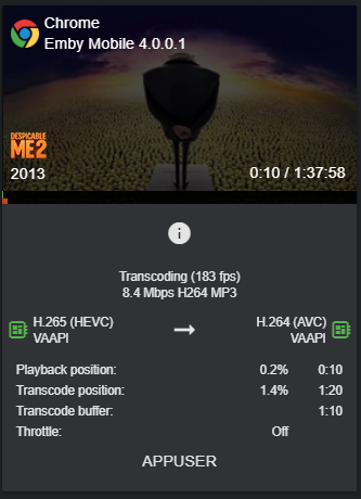

Emby 4.0 now has a nice little logo to confirm hardware transcoding
Here is what I have in my docker template, you will need to add extra parameters over the default. If you already have Emby, you will need to modify your template to add extra parameters.  This is easy to do with the "+Add another Path, Port, Variable, Label or Device" when editing your install.

Checkout the transcode section just in chase, click advanced and it will show you what was detected.
