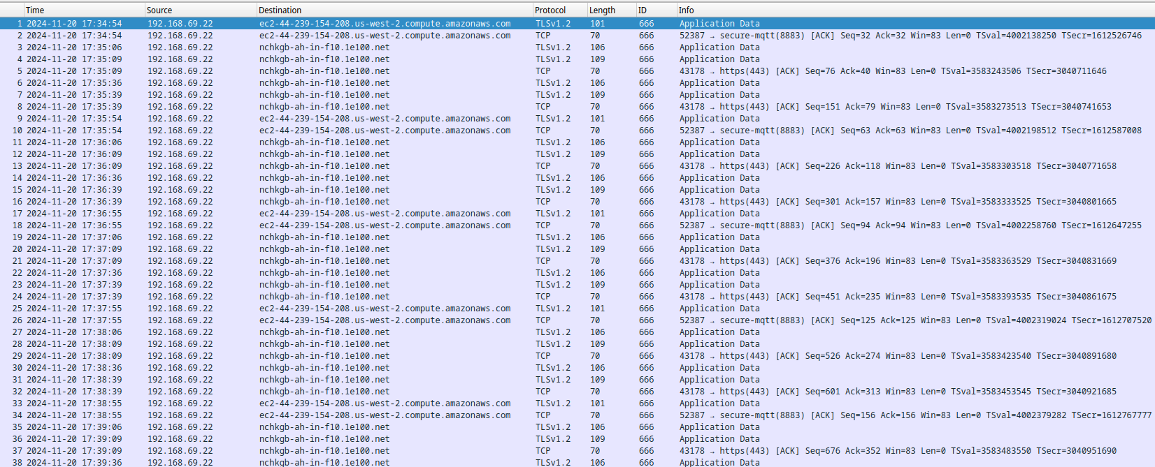

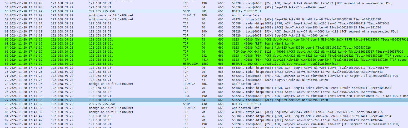

Home Assistant OS seems to have isolated VLAN.
Sure.
I don't mean not trust your founding, but as mention, I haven't found HA will that, no matter it is VM or docker. Below are some capture for your ref. too. Capture the source.mac ( HA ) and destination.mac ( router ), you will got Internet traffic only. But if by source.mac ( HA ), then you will see local traffic also. Could you try setup a new HA for testing / troubleshoot ?
If only HA VM will route local subnet traffic through gateway then it is HA problem. But I never found this with HA in VM or Docker. Pls also note, local traffic ( same subnet ) won't route to gateway, so those traffic go out from the interface ( could be virtual interface binding ) are not in same subnet actually.
