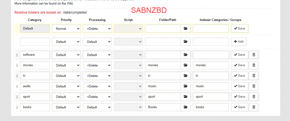

  • When deluge is finished, it's telling Sonarr that the file is stored in /data/completed/..., but you don't have /data/completed mapped to /downloads/completed on sonarr or radar  Add that mapping, and

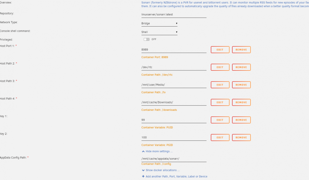

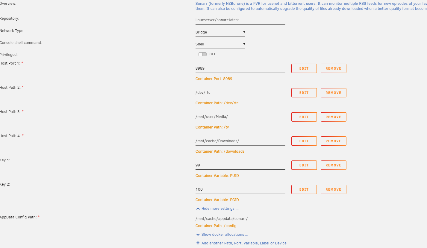

I am at a loss.  Sonarr has worked well for years, now suddenly it cannot find the path for completed downloads.  Nothing, that I am aware of, has changed on my server.  I have tried changing the /data paths, but nothing seems to make a difference...
2021-07-15 17:30:59.3|Error|DownloadedEpisodesImportService|Import failed, path does not exist or is not accessible by Sonarr: /data/completed/tv/I_TOOK_OUT_THE_FILE_NAME. Ensure the path exists and the user running Sonarr has the correct permissions to access this file/folder.
Any help is appreciated.

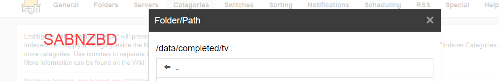

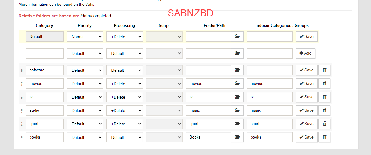

The container configs in the screen captures are the /data paths for both sonarr and SABnzbd
Edited by beaverly72
Your container path in sab is /data and your container path in sonarr is /downloads  you need to make them both the same (ie: /data)
Dang it. My bad, that did it.
thanks

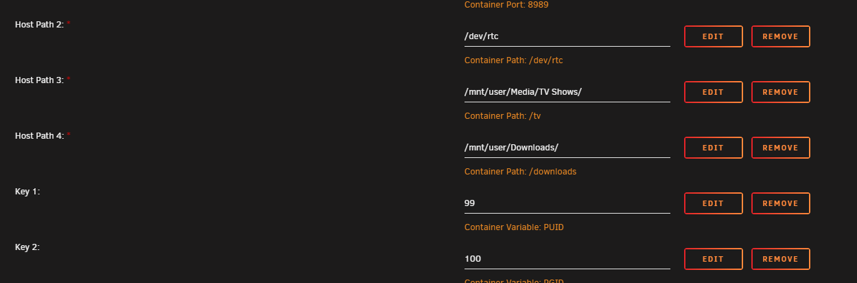

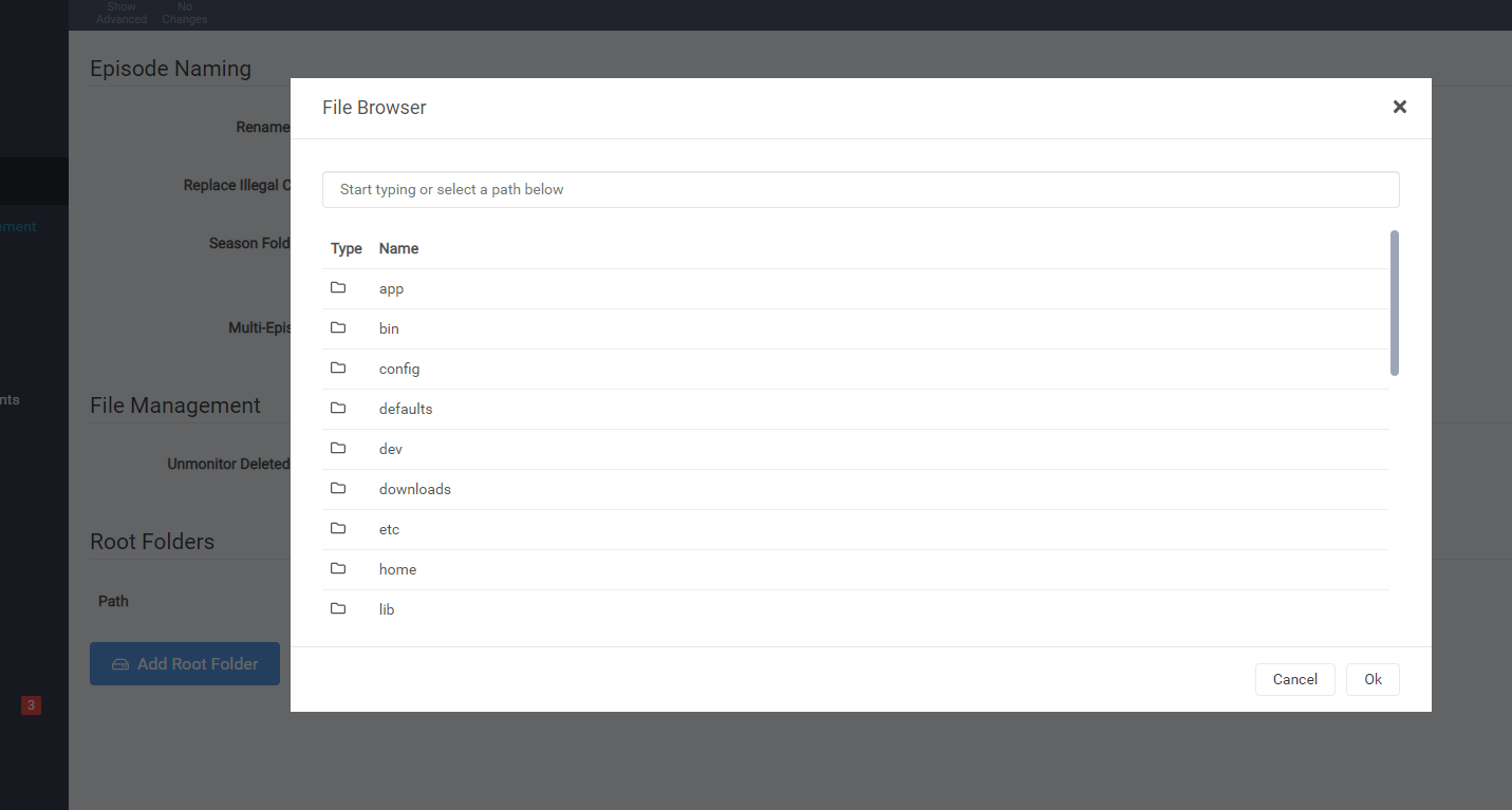

For the absolute life of me I cannot get this working.
/mnt is completely empty.
here is my config.
I cant access any of the shares
You should be telling Sonarr to look in /tv for your media
Exactly. Look at the container paths in this screenshot. /tv and /downloads are where /mnt/user/Media and /mnt/cache/Downloads will appear respectively. Docker containers are like miniature computers all isolated from the host. They only have access to what you tell them.

Im sure its my fault and something simple, but I get the following error...
Import failed, path does not exist or is not accessible by Sonarr: /Downloads/Complete/Angel.S05E20.1080p.WEB.h264-NOMA/. Ensure the path exists and the user running Sonarr has the correct permissions to access this file/folder
Read the post directly above yours.

Since using Sonarr and Sabnzbd I'm experiecing very slow import times. I've setup the /data folders of Sabznbd and Sonarr exactly the same and Sonarr can find the download files just fine, but only the import is very slow. It looks like it's reading the files at ~ 30 MB/s and after a few seconds writing at the same 30 MB/s. This makes the whole downloading process of a series slow (especially when having a 1 GBit/s internet connection).
The destination folder of my series in Sonarr is a MergerFS folder located at /data/mount_mergerfs/TV/, but it' still inside the same folder range Sonarr and Sabnzbd have access to (local: /mnt/user/, Container path: /data).
The MergerFS folder has a local folder on the same NVMe SSD. So I think this shouldn't be the bottleneck.
Thanks for helping!
