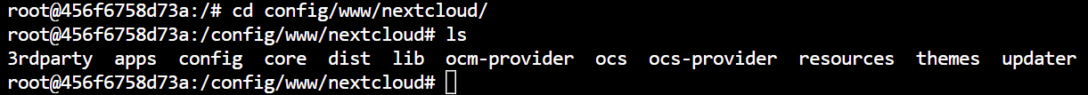

root@270d2b3bc200:/# which occ
/usr/bin/occ
it now resides inside the container in the standard /usr/bin ... you can just tyoe "occ" in the terminal as note ...

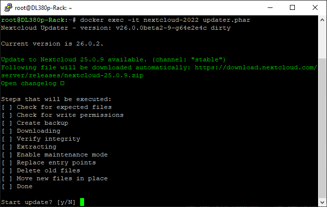

root@_____:~# docker exec -it nextcloud updater.phar
Nextcloud Updater - version: v26.0.0beta2-9-g64e2e4c dirty
Current version is 26.0.2.
Update to Nextcloud 25.0.9 available. (channel: "stable")
Following file will be downloaded automatically: https://download.nextcloud.com/server/releases/nextcloud-25.0.9.zip
Open changelog ↗

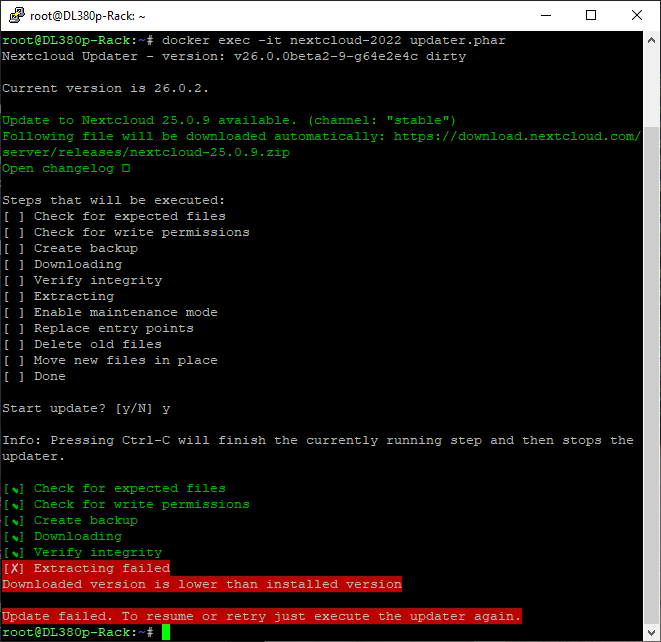

Start update? [y/N] y
Info: Pressing Ctrl-C will finish the currently running step and then stops the updater.
[✔] Check for expected files
[✔] Check for write permissions
[✔] Create backup
[✔] Downloading
[✔] Verify integrity
[✘] Extracting failed
Downloaded version is lower than installed version
Update failed. To resume or retry just execute the updater again.
root@_____:~#
