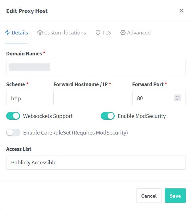

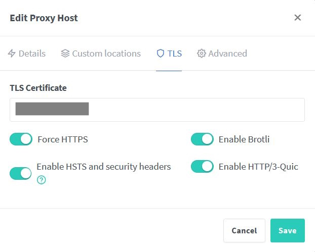

NPMplus beste Konfiguration: Die Einstellungen unter NPMplus sind ein bisschen anders als wie mit NginxProxyManager. Die Ideale Konfiguation für Nextcloud ist: Details: TLS: Advanced: more_set_headers "X-XSS-Protection: 1; mode=block"; proxy_set_header X-Forwarded-For $proxy_add_x_forwarded_for; proxy_set_header X-Real-IP $remote_addr; client_body_buffer_size 256k; proxy_read_timeout 86400s; client_max_body_size 0; location /.well-known/carddav { return 301 $scheme://$host/remote.php/dav; } location /.well-known/caldav { return 301 $scheme://$host/remote.php/dav; } location /.well-known/webfinger { return 301 $scheme://$host/index.php/.well-known/webfinger; } location /.well-known/nodeinfo { return 301 $scheme://$host/index.php/.well-known/nodeinfo; } -
