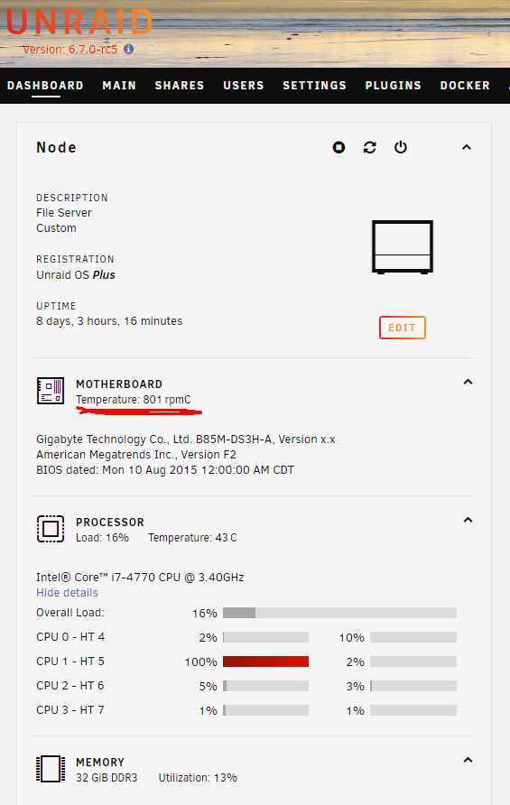

I am seeing what appears to be fan RPMs displayed under the motherboard temperature area. I am on the latest BIOS now (F3, this was taken before I updated) and still have the RPMs showing up in the temp area. Diagnostics: node-diagnostics-20190305-1449.zip
Perl is installed and up to date.
This does not happen on my server at home which is also on RC5  with the Dynamix system temp plugin but with a different motherboard.
