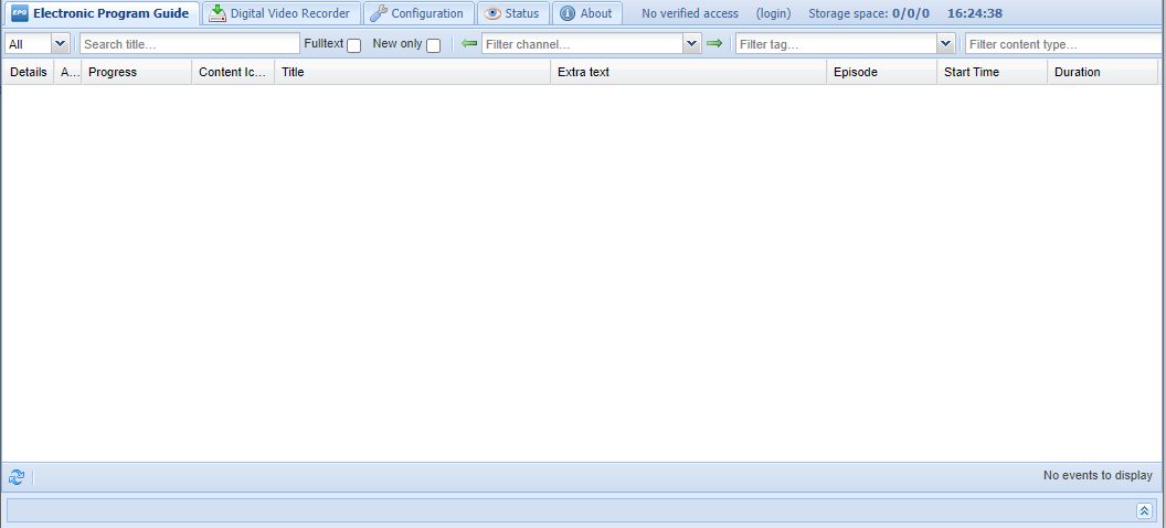

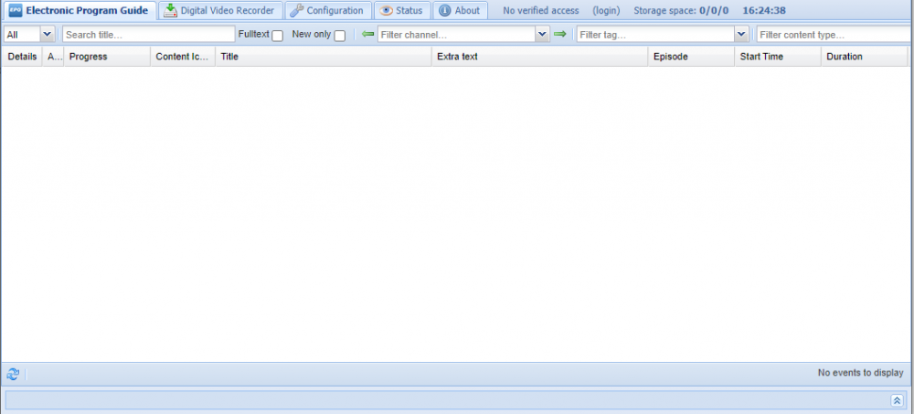

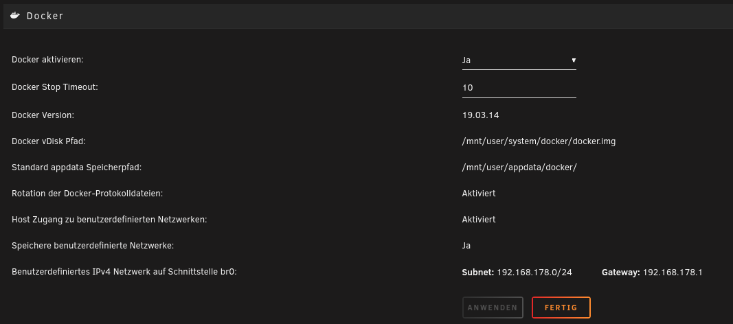

platoboos Posted March 1, 2021 Share Posted March 1, 2021 6 minutes ago, mattie112 said: Can you confirm that your backend works when you go to http://192.168.178.103:9981? Do you have any other hosts configured? Do they work or do they also have problems? http://192.168.178.103:9981 works fine. Other hosts works the only problem is tvheadend Quote Link to comment

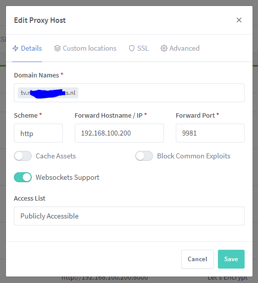

mattie112 Posted March 1, 2021 Share Posted March 1, 2021 22 minutes ago, platoboos said: http://192.168.178.103:9981 works fine. Other hosts works the only problem is tvheadend I installed "linuxserver/tvheadend" through the CA app store Then I added a host to NPM And yeah what can I say, I can now access it: So: what is different with your config? It seems to work just fine here. Quote Link to comment
platoboos Posted March 1, 2021 Share Posted March 1, 2021 28 minutes ago, mattie112 said: So: what is different with your config? It seems to work just fine here. I use macavlan for network because I use Sat IP. I think you test it with bridge mode Quote Link to comment

platoboos Posted March 7, 2021 Share Posted March 7, 2021 On 3/1/2021 at 4:25 PM, mattie112 said: I installed "linuxserver/tvheadend" through the CA app store Then I added a host to NPM And yeah what can I say, I can now access it: So: what is different with your config? It seems to work just fine here. I resolved my problem. I change the docker network settings for other networks to "yes" thanks Quote Link to comment

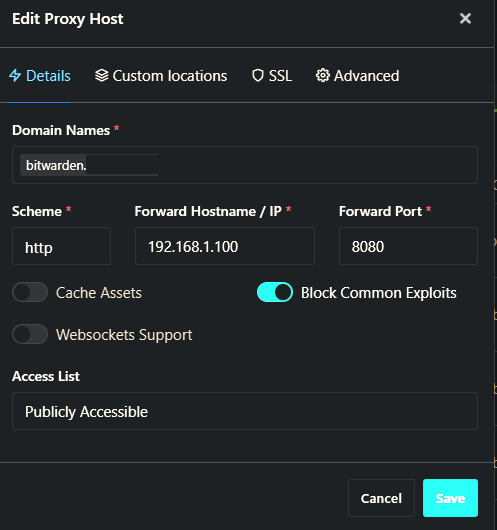

evakq8r Posted March 14, 2021 Share Posted March 14, 2021 (edited) Hi there, Hoping this is the right place to report issues.. if not, please redirect as needed. Also, sorry for the long post. TL;DR: Bitwarden on NPM results in 'unexpected error' on login. Bitwarden on SWAG results in no issues. SETUP: Host OS: Unraid 6.9.1 Containers with issues: Bitwarden (via docker-compose) and NginxProxyManager I've spent this weekend trying to migrate from SWAG to NPM (mainly for testing, but having a UI to do most of the NGINX work is nice too). All my containers work, except Bitwarden... this one keeps failing intermittently. I've also implemented Authelia with NPM following https://github.com/ibracorp/authelia and that works too. I've been unable to use Bitwarden_rs with my Unraid server (see https://github.com/dani-garcia/bitwarden_rs/issues/1071), but have had SWAG work with my Bitwarden install (via docker-compose) without issue for several months. After setting up my Bitwarden instance under NPM, I am able to authenticate using Authelia, which redirects to the public Bitwarden address I have setup, but after attempting to login, it fails for 'unexpected error has occurred'. I've tried digging through the bitwarden-mssql, bitwarden-admin and bitwarden-nginx logs for errors, but none appear. If I turn off NPM and swap back to SWAG, I can log in without error. Configs: SWAG:- server { listen 443 ssl; listen [::]:443 ssl; server_name bitwarden.*; include /config/nginx/ssl.conf; client_max_body_size 128M; # enable for ldap auth, fill in ldap details in ldap.conf #include /config/nginx/ldap.conf; # enable for Authelia # include /config/nginx/authelia-server.conf; location / { # enable the next two lines for http auth #auth_basic "Restricted"; #auth_basic_user_file /config/nginx/.htpasswd; # enable the next two lines for ldap auth #auth_request /auth; #error_page 401 =200 /ldaplogin; # enable for Authelia # include /config/nginx/authelia-location.conf; include /config/nginx/proxy.conf; resolver 127.0.0.11 valid=30s; set $upstream_app bitwarden-nginx; set $upstream_port 8080; set $upstream_proto http; proxy_pass $upstream_proto://$upstream_app:$upstream_port; } location /admin { return 404; } location /notifications/hub { include /config/nginx/proxy.conf; resolver 127.0.0.11 valid=30s; set $upstream_app bitwarden-nginx/; set $upstream_port 8080; set $upstream_proto http; proxy_pass $upstream_proto://$upstream_app:$upstream_port; proxy_set_header Upgrade $http_upgrade; proxy_set_header Connection "Upgrade"; } location /notifications/hub/negotiate { include /config/nginx/proxy.conf; resolver 127.0.0.11 valid=30s; set $upstream_app bitwarden-nginx; set $upstream_port 8080; set $upstream_proto http; proxy_pass $upstream_proto://$upstream_app:$upstream_port; } } NPM:- location /authelia { internal; set $upstream_authelia http://192.168.1.100:9091/api/verify; proxy_pass_request_body off; proxy_pass $upstream_authelia; proxy_set_header Content-Length ""; # Timeout if the real server is dead proxy_next_upstream error timeout invalid_header http_500 http_502 http_503; client_body_buffer_size 128k; proxy_set_header Host $host; proxy_set_header X-Original-URL $scheme://$http_host$request_uri; proxy_set_header X-Real-IP $remote_addr; proxy_set_header X-Forwarded-For $remote_addr; proxy_set_header X-Forwarded-Proto $scheme; proxy_set_header X-Forwarded-Host $http_host; proxy_set_header X-Forwarded-Uri $request_uri; proxy_set_header X-Forwarded-Ssl on; proxy_redirect http:// $scheme://; proxy_http_version 1.1; proxy_set_header Connection ""; proxy_cache_bypass $cookie_session; proxy_no_cache $cookie_session; proxy_buffers 4 32k; send_timeout 5m; proxy_read_timeout 240; proxy_send_timeout 240; proxy_connect_timeout 240; } location / { set $upstream_app bitwarden-nginx; set $upstream_port 8080; set $upstream_proto http; proxy_pass $upstream_proto://$upstream_app:$upstream_port; location /notifications/hub { set $upstream_app bitwarden-nginx/; set $upstream_port 8080; set $upstream_proto http; proxy_pass $upstream_proto://$upstream_app:$upstream_port; proxy_set_header Upgrade $http_upgrade; proxy_set_header Connection "Upgrade"; } location /notifications/hub/negotiate { set $upstream_app bitwarden-nginx; set $upstream_port 8080; set $upstream_proto http; proxy_pass $upstream_proto://$upstream_app:$upstream_port; } auth_request /authelia; auth_request_set $target_url https://$http_host$request_uri; auth_request_set $user $upstream_http_remote_user; auth_request_set $groups $upstream_http_remote_groups; proxy_set_header Remote-User $user; proxy_set_header Remote-Groups $groups; error_page 401 =302 https://<auth.domain.com>/?rd=$target_url; client_body_buffer_size 128k; proxy_next_upstream error timeout invalid_header http_500 http_502 http_503; send_timeout 5m; proxy_read_timeout 360; proxy_send_timeout 360; proxy_connect_timeout 360; proxy_set_header Host $host; proxy_set_header Upgrade $http_upgrade; proxy_set_header Connection upgrade; proxy_set_header Accept-Encoding gzip; proxy_set_header X-Real-IP $remote_addr; proxy_set_header X-Forwarded-For $proxy_add_x_forwarded_for; proxy_set_header X-Forwarded-Proto $scheme; proxy_set_header X-Forwarded-Host $http_host; proxy_set_header X-Forwarded-Uri $request_uri; proxy_set_header X-Forwarded-Ssl on; proxy_redirect http:// $scheme://; proxy_http_version 1.1; proxy_set_header Connection ""; proxy_cache_bypass $cookie_session; proxy_no_cache $cookie_session; proxy_buffers 64 256k; set_real_ip_from 192.168.1.0/24; real_ip_header X-Forwarded-For; real_ip_recursive on; } I've tried cycling SSL, HSTS and HTTP2 on and off with no difference to the outcome. I can also access the local IP of Bitwarden and login without error while NPM is configured, which makes me think this is specifically an NPM problem. Happy to be corrected. Any help would be appreciated. Thanks for reading. EDIT: The 'auth.domain.com' is normally filled in, but has been substituted for posting purposes (is normally auth.<mydomain>.<mydomain>) EDIT2: After many hours of pulling my hair out, finally resolved the issue. Turns out the configs between SWAG and NPM are defined slightly differently. In SWAG, the bitwarden-nginx port is pointed to 8080, however in NPM it needed to be pointed to my custom port that was defined during the docker-compose... Now it works without issue! Edited March 20, 2021 by evakq8r Fixed Quote Link to comment

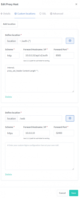

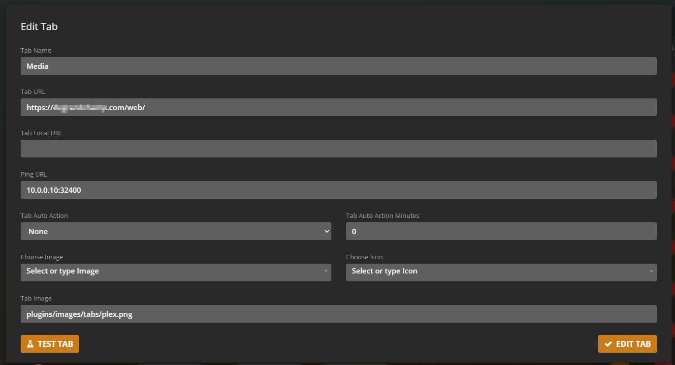

i1mran92 Posted March 17, 2021 Share Posted March 17, 2021 On 1/4/2021 at 4:56 AM, CorneliousJD said: I'm tight on time right now but hope this helps. If not let me know - can work to gather more info later. Primary domain.com setup in NPM which hosts Organizr -- this should be perfectly straight forward. Next is custom locations. - first part is for organizr auth - you can ignore this part if you don't want it, and focus on the /web part at the bottom. NOTE the HTTPS part on my /web -- I needed this to get it to work correctly, and it HAD to be /web too, /plex didn't work for me here at all. Organizr SSO settings. Media/Plex tab settings. Happy to try and help more if this doesn't do it for you - but replicate this exactly first and if it's still erroring out let me know. I finally manage to get back to this and happy to say it works now thanks to you. i really appreciate it! thanks so much! Quote Link to comment
