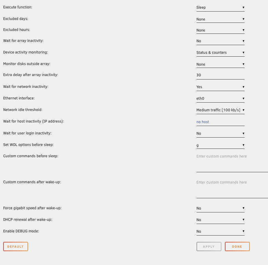

I have some problems with the S3 Sleep plugin. It's a bit too eager to put the system into sleep.... ;-)
I have execute function on Sleep but no matter what options (Wait for array or Monitor Disks outside) I select it wil ALWAYS put computer to sleep after the Extra Delay after array inactivity.
My disks spin down after 30 mins. Extra delay is set to 5 mins. No matter if the array is active or not it puts my server to sleep after 5 mins. I tried enabling and disabling the "Wait for array inactivity" and select all of the array disks in "Monitor disks outside the array" but after 5 mins, computer goes to sleep.
Tried re-install but results are the same.
The disk activity checker function is broken in the current unRAID version.  No one knows when or if it will get fixed.
Thx for the answer. It worked before indeed, I really depend on it. I'll try the network activity monitor, does it respect the 30 mins wait or is that only for array status?

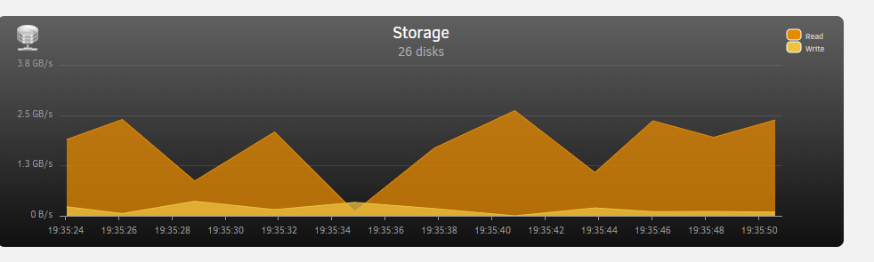

running 2024.01.05 (my birthday!) and unraid 6.12.6 and in the system stats tab, the storage graph shows 26 disks,
But I have 45 disks, 44 of them are in a ZFS pool.
1. can I do something to update the disks
2. does the graph speeds represent 26 or 45 disks as it is? (If it represents all of them, I dont care that it says 26)

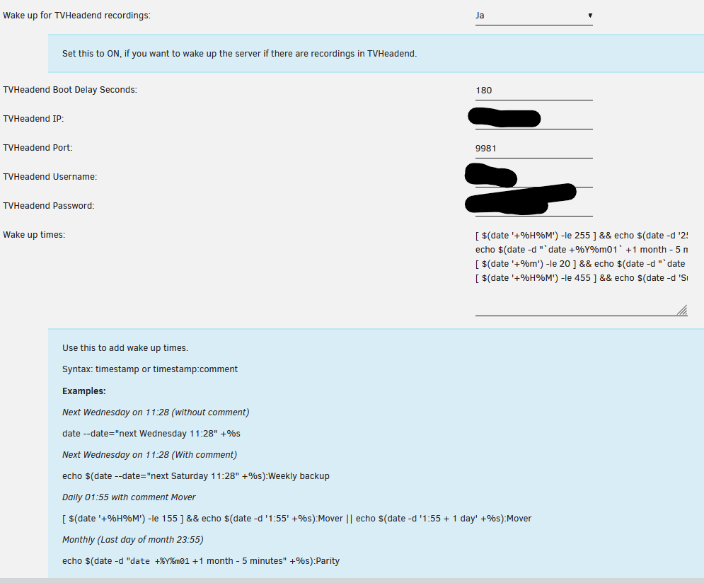

Hi
i have made a few improvements to the S3 sleep plugin. One of them is that the disk activity checker is now fixed.
I have implemented the features mainly for myself. Therefore, not everything is 100% tested. If I find some time and the TVHeadend integration is ok for @bonienl I will do a PR. Feel free to use my fork that solves the disk activity problem until @bonienl solves the problem.
@bonienl See here for the fix: https://github.com/chriss158/dynamix/commit/98213df2c70ab4ee7f08475148ff31b51e677d67
i have made the following improvements.
- Check if a recording is currently running in TVHeadend or TVheadend is running a subscription (Live TV)
- Wake up the server when a TVHeadend recording is scheduled
- Custom wake-up times for the server, for example to wake up the server for a backup or the parity check
- Before shutdown/sleep, check whether the next wake-up time is within a defined time (15 minutes). If so, the shutdown/sleep is canceled
- Changed the option "Extra delay after inactivity" so that it runs not only after the inactivity of the array, but after all checks.
- Add check for running processes. e.g. backup script, wget, cp, rclone etc.
You can get the plugin from my forked repository: https://raw.githubusercontent.com/chriss158/dynamix/master/unRAIDv6/dynamix.s3.sleep.plg
For each new option there is an explanation when you click on the option.
The TVheadend implementation is based on the work of https://github.com/git-developer/autosuspend
So thanks to him :D
