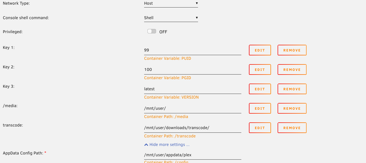

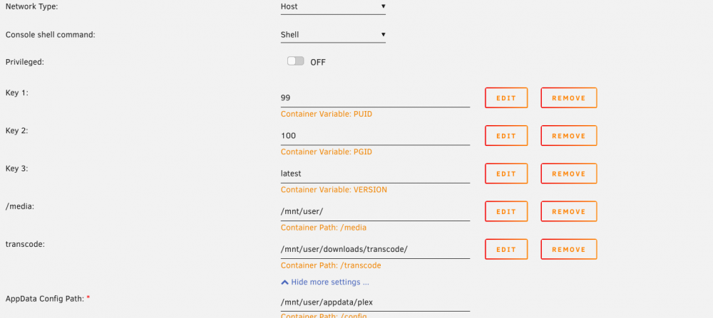

Hey guys, need some help please. I've been trying to get install plex on my newly-built unraid all day today and finally got it working with linuxserver.io docker, (binhex vresion did not work for me) so thank you!
My issue is that plex is showing as unavailable outside of my network. I had it working perfectly with plex runinng on a mac mini and just consolidated today after upgrading my unraid. I have port-forwarding enabled on my router and updated the ip on the router to the unraid machine 192.168.1.2. Perhaps it needs to be a different ip because of the docker instead of forwarding everything to the unraid server itself? I am attaching a screen shot here.
Also, did I set up transcoding path correctly? I want to transcode to my cache SSD. I have a share called "downloads" that I sent to use cache-only and created a folder called "transcode" on that share for plex.
Help!
*EDIT* Weird but all of a sudden that plex remote server icon turned green and now it's showing as accessible outside of my network. I guess it takes a bit to refresh?
I also never had a default container path /media, I had to add that by myself (good thing I read a ton on how dockers work and paths before this). But is this normal? I thought it would be be part of the docker template by default like /config was.
What do you guys think of everything else though including how I forwarded the port on my router to unraid server? There's no way to make it go to a virtual ip directly to the plex docker only correct?
Help!
18
Your plex works fine outside the network. BTW. Please edit that picture because everybody can see your IP. You are exposing yourself, be careful.
Oh my goodness, thanks, I erased the pic, thank you
