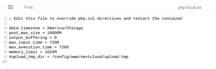

I used THIS link to setup the TEMP directory in Nextcloud/Swag. I think I got those portions completed. In the Nextcloud>PHP> php-local.ini file do I need to define the TEMP directory so NC knows to use it? See attached pic; I think like last line is what I would use? Just not sure what the directory structure would be using the guide I link to above. Can someone confirm the php-local..ini file needs edited to include the temp directory? Can someone say what temp directory would be listed as in the php-local.ini file if so in reference to how completed above?
Please help 😞

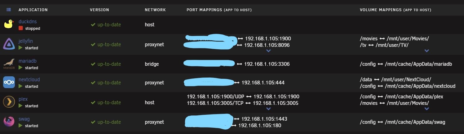

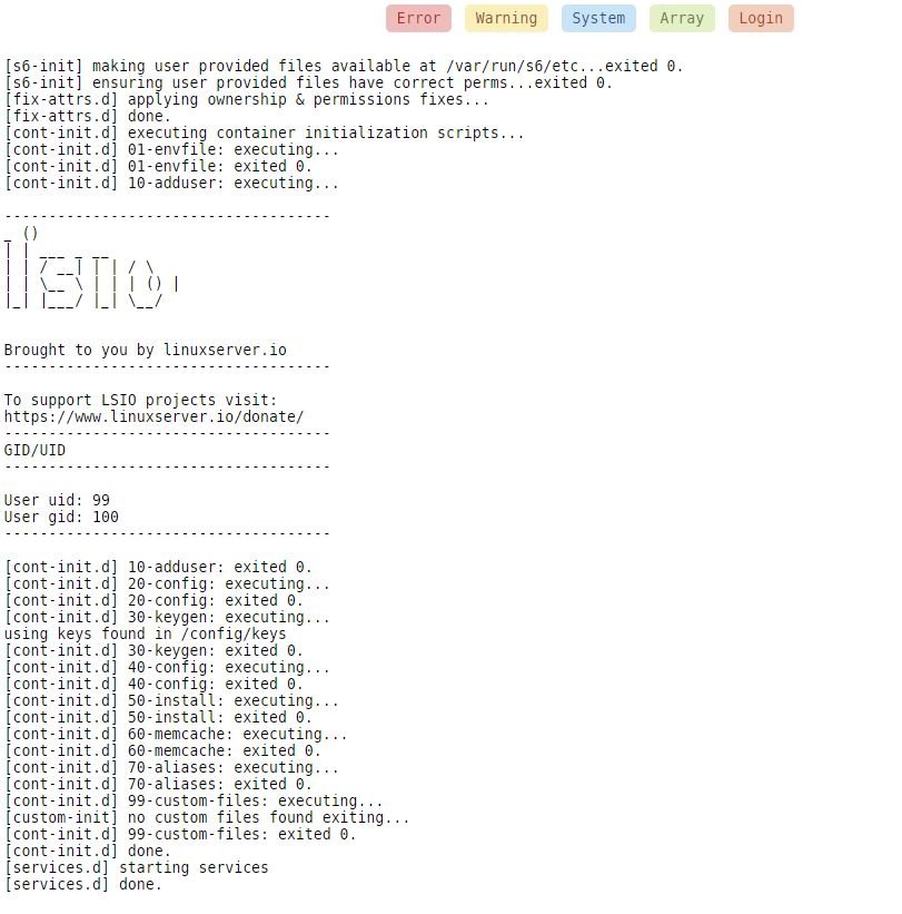

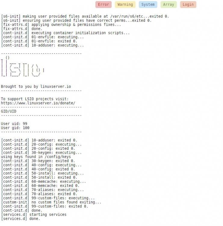

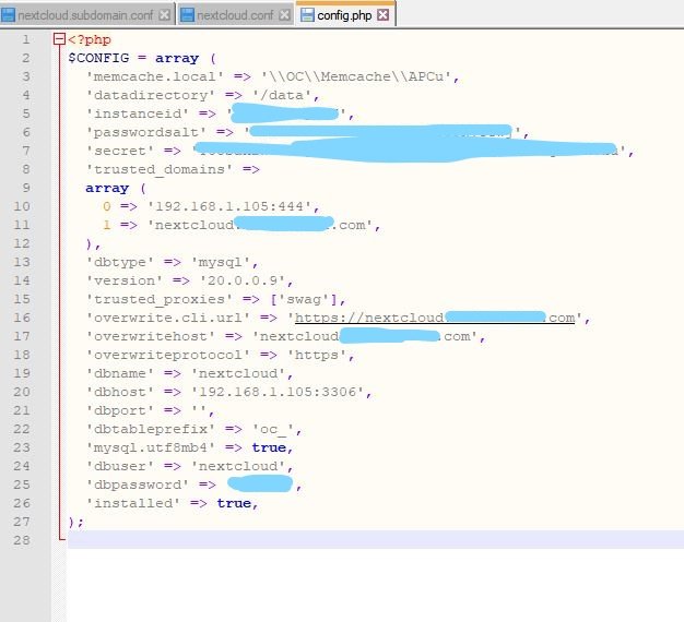

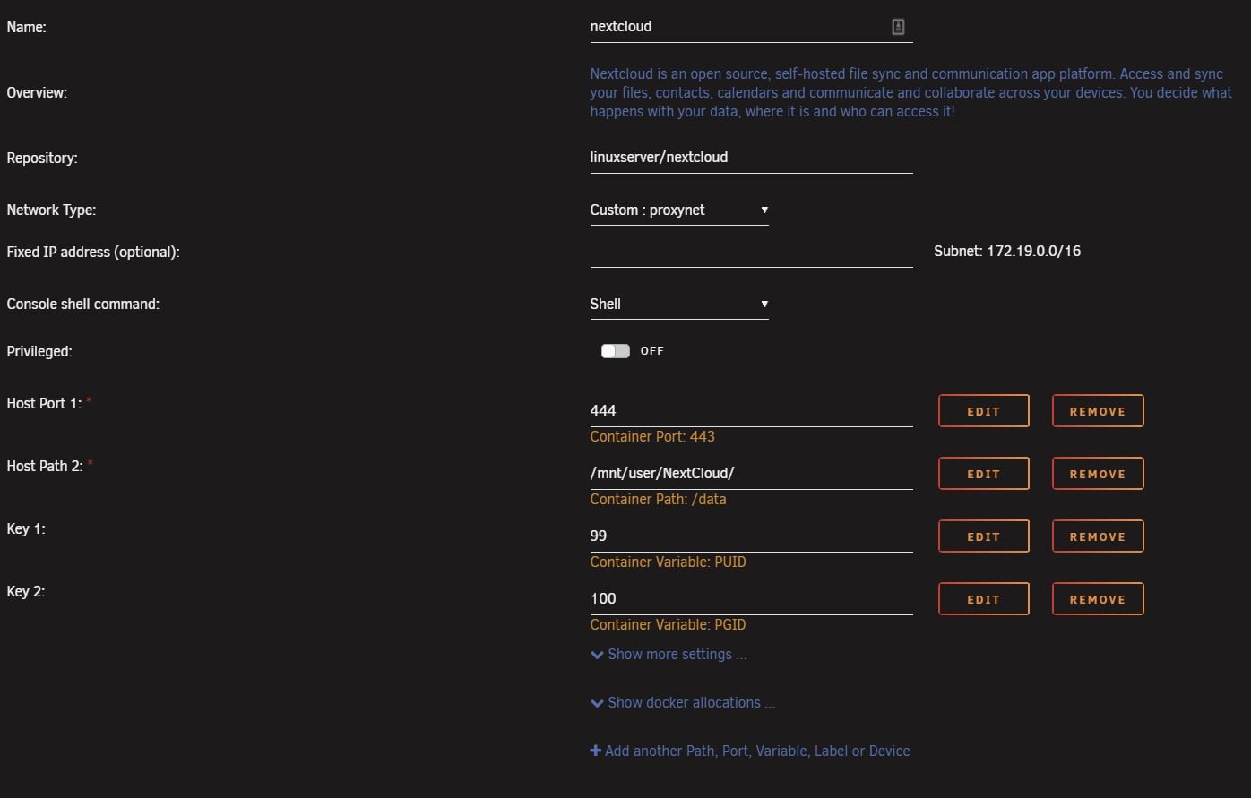

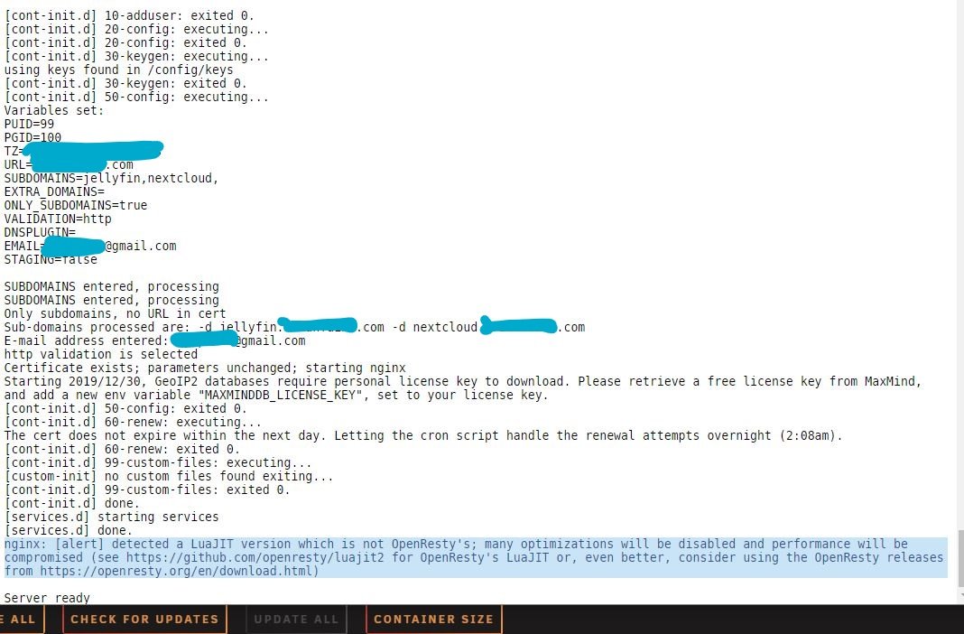

IM GOING INSANE.
I had various issues that caused me to have to completely redo all my dockers and cache drive swap.
That being said everything is back up and running as expected EXCEPT Nextcloud
I can't access Nextcloud locally or remotely.
I've gone through countless forums and threads trying to find help but they immediately go into the weeds and dead end or aren't helpful.
Unraid v6.8.3
Using subdomains for access. (I had this all working perfectly before the cache swap.) Only difference now is Swag instead of letsencrypt docker)
Swag for reverse proxy
Ports forwarded properly on the router
Mariadb make a database for Nextcloud to use (Jellyfin is using same custom network and I can locally and remotely access it)
Right after I set up Nextcloud I was able to access it via local ip and set it up as you should and did some simple configuration. Then I moved on to other dockers. I added Jellyfin and configured it. Now Nextcloud is 100% inaccessible, they don't share any ports.  I've edited all the config files as specified by SpaceInvader and various forum posts. Nothing helps. I've rebooted the server countless times during the whole process. Restarted dockers after any change.
Locally with IP I get nothing "this site cannot be reached" with subdomain address I get 502 bad gateway ngix 1.18.0
Please be gentle Im not a pro with all this stuff.  I followed SpaceInvaderOne tutorials for setting up Nextcloud, Letsencrypt/Swag as I did before and everything worked. Now this time around, it's just not working. (last time was 4 months ago) I don't understand how I did the Jellyfin setup the exact same way and it works but Nextcloud is just broken.  I found others saying to just nginx proxy manager docker but no one has information on how to exactly do so. Some people said it's a DNS issue but didn't offer any help or information on how to resolve that.  As much love as I have for SpaceInvader I think his video might be outdated or Nextcloud has been altered in someway to make it no longer relevant way to install and access remotely this is clear to me as im not the only one having these types of issues.
It's always a headache... One little configuration screws it all up for me every single time I touch my server.
tower-diagnostics-20201008-1650.zip
Edited by in_trauma
